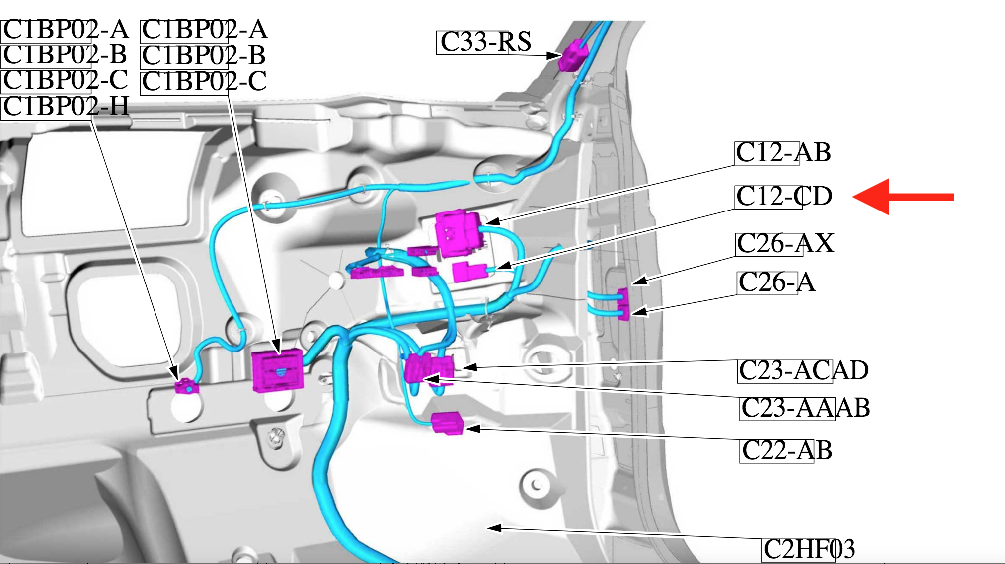

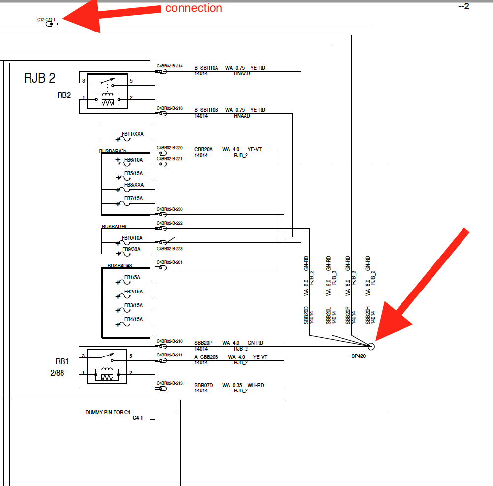

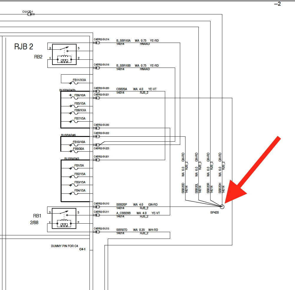

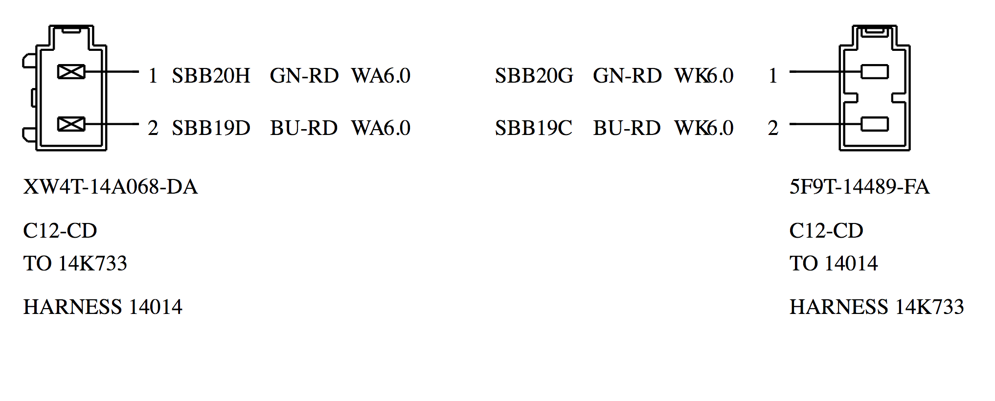

I have send you a personal message with the wirering of the rear junction box
You search the first connection point for the wire for the F20 fuse
this is the place who is the connector.
