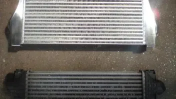

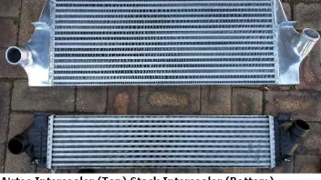

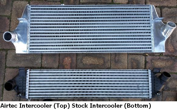

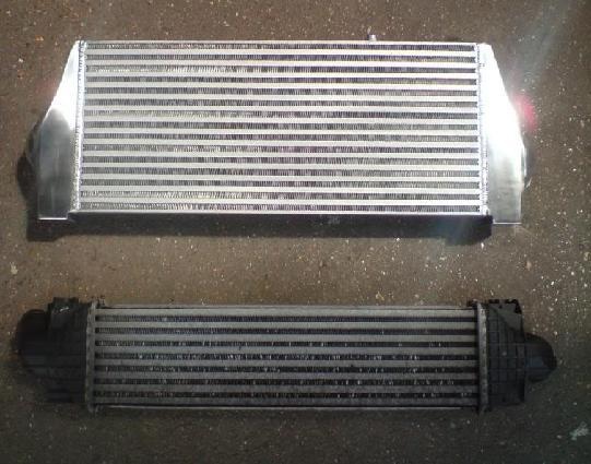

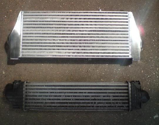

    The pics shown in this add, is not the intercooler used in the TDCi models, but the 2.5 T model. For the pics of a 1.8/2.0/2.2 TDCi intercooler compaired to an upgraded Airtec intercooler, please look at my own pics attached 8)

    Yes thats the one. The one I ordered from Airtec, was the one they post as for the 2.0/2.2 TDCi. When you look at the pics I attached, you can see one small intercooler (my standard 1.8 TDCi intercooler) next to the upgraded one I got from Airtec.

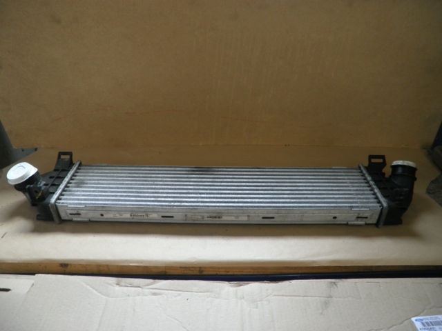

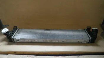

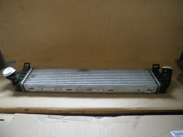

    The pic with the "solo" intercooler, shows a 2.0 TDCi intercooler I borrowed in order to compare the piping on the one I had standard on my 1.8 TDCi.....
    When I say - almost plug-and-play - I had to remove the big plastic potrection plate under the engine to get more space in order to unscrew the intercooler hoses, the bolts at the metal clamps were stuck/coroded! So I replaced them with new ones when I had the chance. The job took me appx. 2,5 hours in total from start to finish. The Airtec manual said max 2 hours for the job!
    Now I am going for a Blurfin OBD upgrade, but driving with standard the program works well. No turbo lag, but more "pull" when I give he car sone power :D I have no numbers on the increase of ps/Nm, but allready I can feel it pulls more and use les diesel....... Maby 3-5ps more, but atleast 15-20Nm more without th updated OBD program........

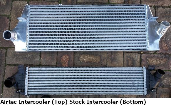

  • Wie meinst Du das mit "ob großer oder kleiner LLK"? Auf dem Bild ist der originale zusehen, der ist klein, und der Austausch-LLK ist der große. Oder interpretiere ich hier was falsch?

  • Interessant wäre dann noch ab der Unterfahrschutz wieder dran passt weil der LLK auf dem Bild soweit runter geht
