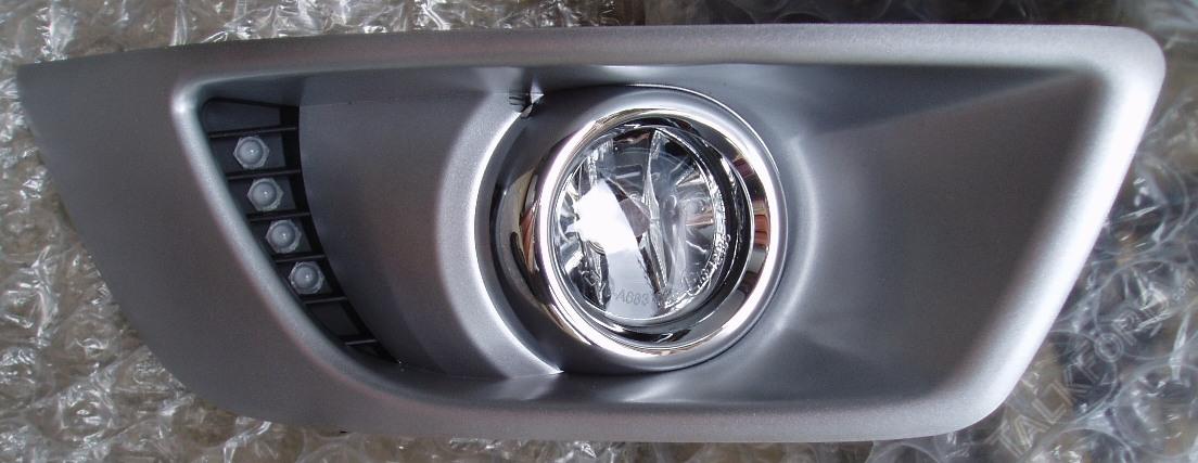

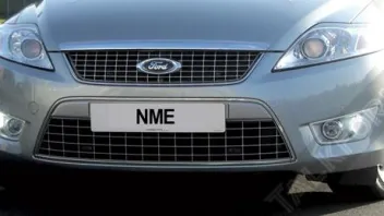

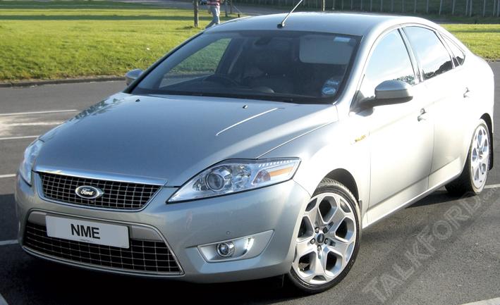

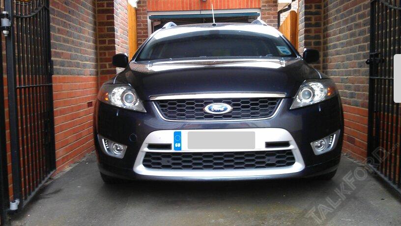

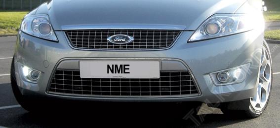

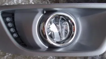

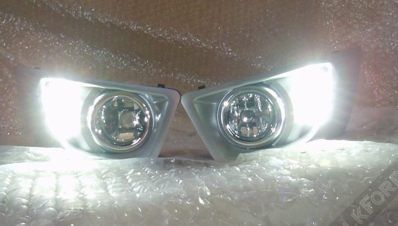

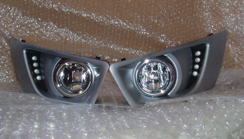

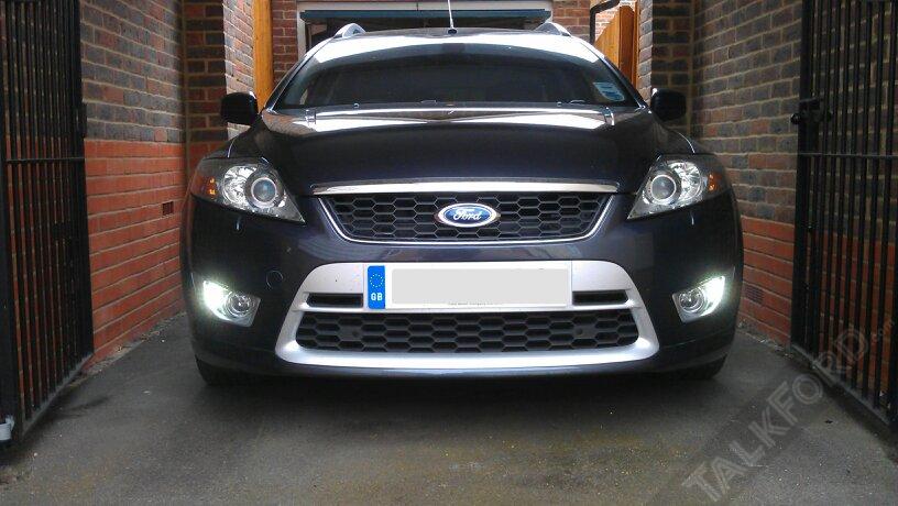

  • Hello gentlemen, just thought I would share with you something that we have been looking at in the UK for fitting to the Sport foglight assemblies. I will be purchasing a set in the next month and will post up a full "how to" guide"

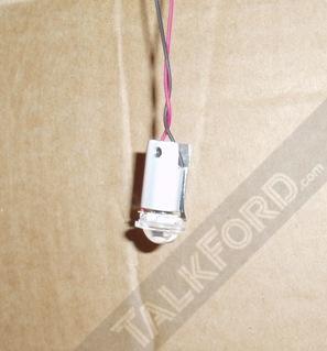

    The lights are basically custom made 1W LED assemblies (running at 0.8W), 4 each side so that’s only 3.2W total each side. Each side is separately powered by a control unit which provides the voltage stabilisation and DRL switching. How you wish to operate them at night, i.e. OFF or reduced light, or how you wish to switch DRL mode (sidelights on or dip beam) will be configurable. Note the LEDs are Ultra White 5700K LEDs, which may be ever so slightly bluer than the HID Xenon.
    The LEDs fit into 10mm holes that require drilling in the web of the ribbed area of the sports foglight and will require bonding in place with sealant. The control unit can be conveniently powered and controlled from the headlight harness of the respective side and it is quite small, being the size of a packet of chewing gum. Instructions will be provided as to which wires to terminate to.
    Approximate time for fitting is 2 hours and will be available as a kit with full instructions.
    For pricing information and further information contact
    4titx@heter.co.uk
    Below are images of pre-production models
