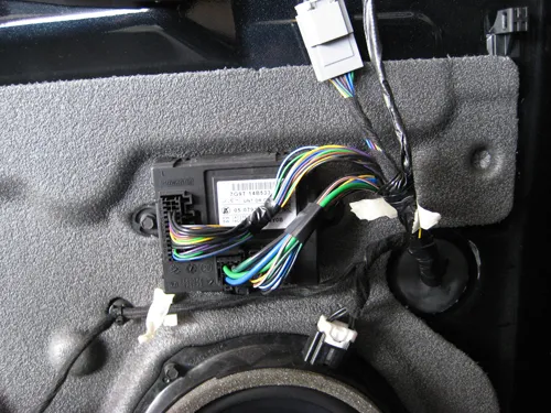

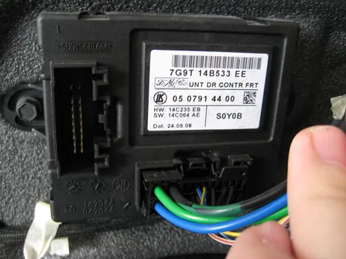

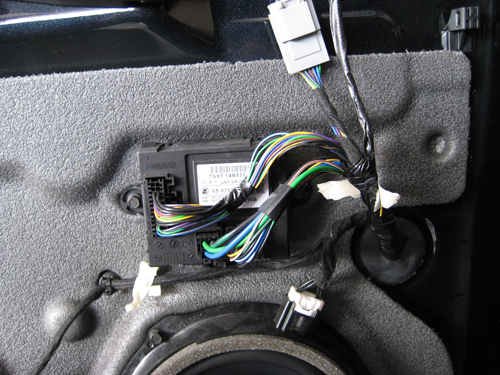

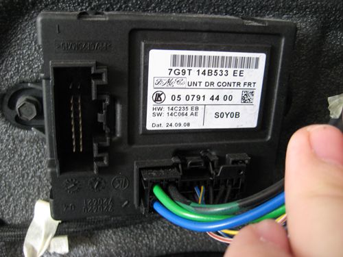

    I am looking for some information about the door control modules from a Mk4 Mondeo with the automatic fold/unfold feature of the side mirrors when locking/unlocking the car from the key fob. I have a Mk4 Mondeo (production date 10.10.2008 ) and sadly my Mondeo “only” is not equipped with the automatic fold/unfold feature but only the manually operated fold/unfold switch inside in the driver side door.
    This is a set of photos of my door control module from the driver side front door and this only has the manually fold/unfold feature:
