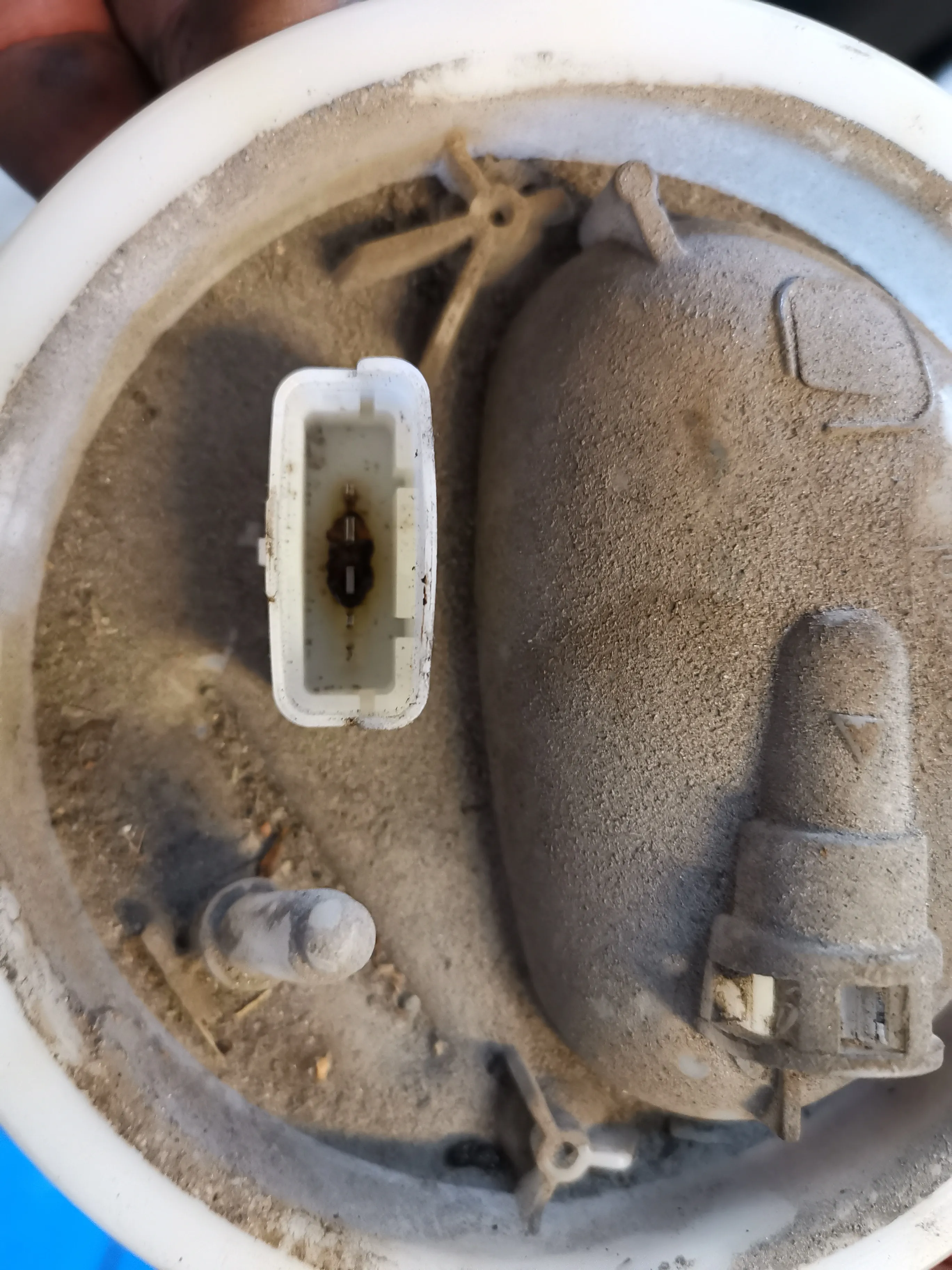

Hi guys, my problem came back yesterday.

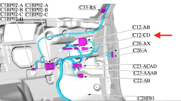

After some googling i am certain the problem is the cable from the petrol pump, 6g9t-14a069.
Before i am jacking the car up to clean the stecker, i would like to see a picture of the stecker underneath the car, so i know where to look.
( not the stecker on the pump, but the other end )
hope you guys can help.

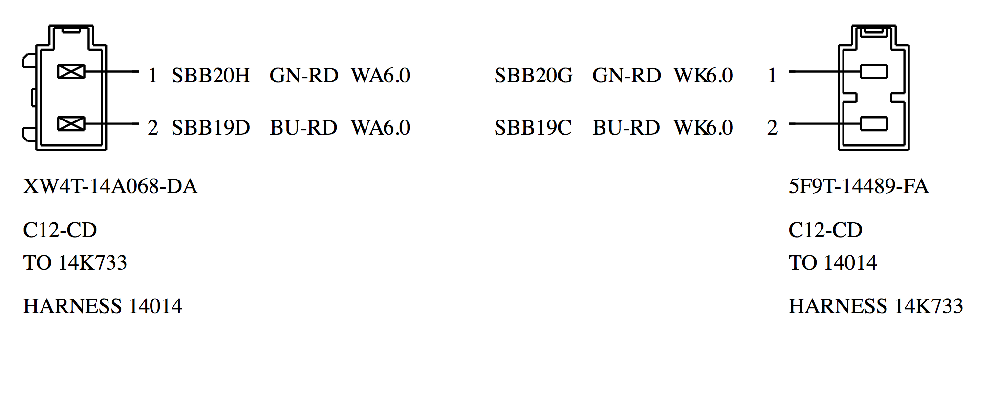

Over the Glove box. In that Connector you will find a blue/red and a green/red wire. the blue red is for the FA-Block in the rear box and the other, the green/red is yours for the FB and FC.
Now you must check from the f20 to that connector and then from connector to Rear Boxhow many ( and were ) are there on the way to RB1?

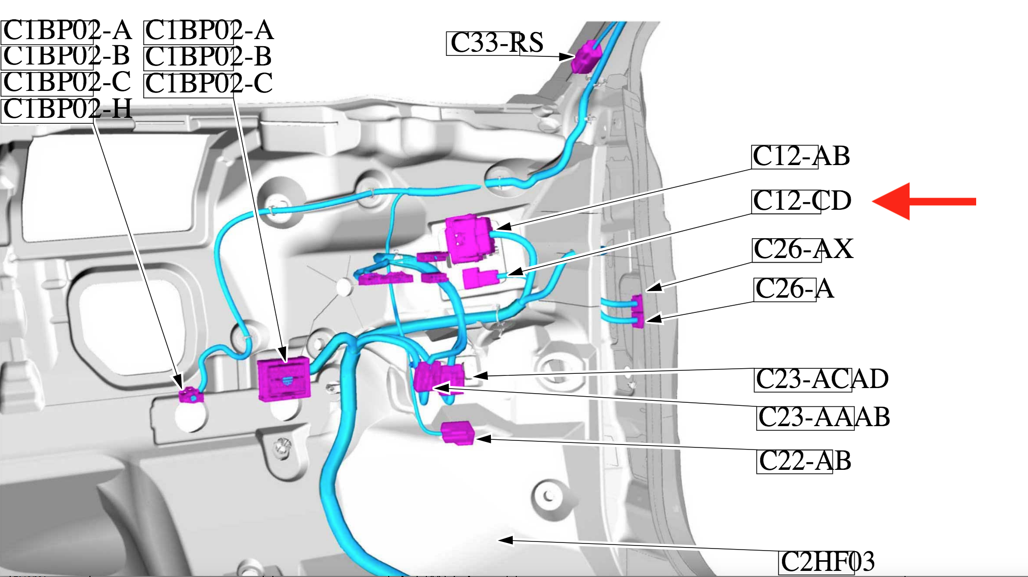

Can you see if F20 goes through a connection/stecker, maybe under the driver seat?

near the rear fusebox is a connection point at which the cable from the
F20 engine box is splitted. From F20 to Rear Box the cable has over the whole lenghth a green/red colour.Do i have to take the fusebox out, to see this?

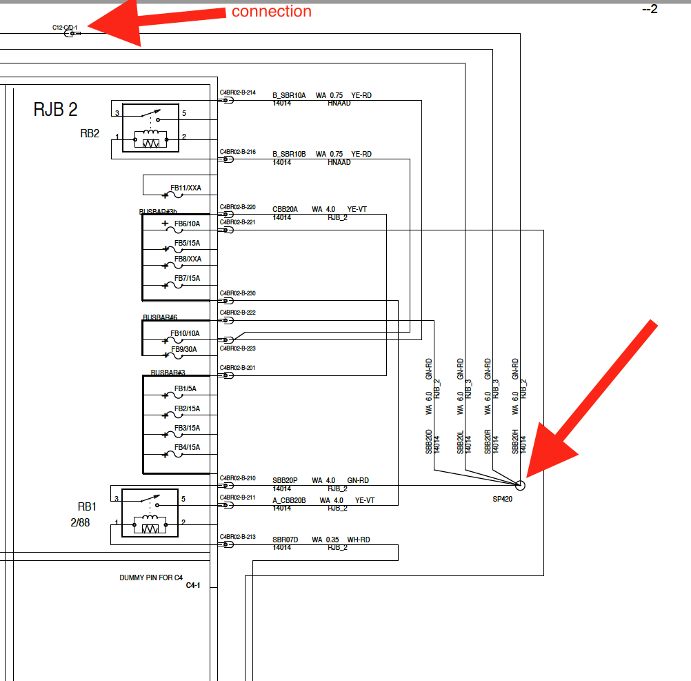

On my car i think fusebox RB is powerede by F18.
Both FB9 and 10 are dead!
On RA1 pin 30 allways has current!
Wire that supplies RB1/pin 30 must be broken.
Where can i find a wiring diagram?
85 = Ground
87 = Relay Power out
30 = must have always 12 V85 and 86 = switching current.
Relay RB 1 switches the Power to Fuses FB 1 to FB 8 Rear Box. Why you do not put in a new Relay and see what happens?
I tried the same relay from RA1, put it in RB1, same same..
without power on pin 30, it must be disconnectet somewhere towards enginbay, perhaps in a connection/stecker?

[Blockierte Grafik: https://imageshack.com/a/img922/4936/wQ2NHR.jpg]
[Blockierte Grafik: https://imageshack.com/i/pmKEw9Tqj]
