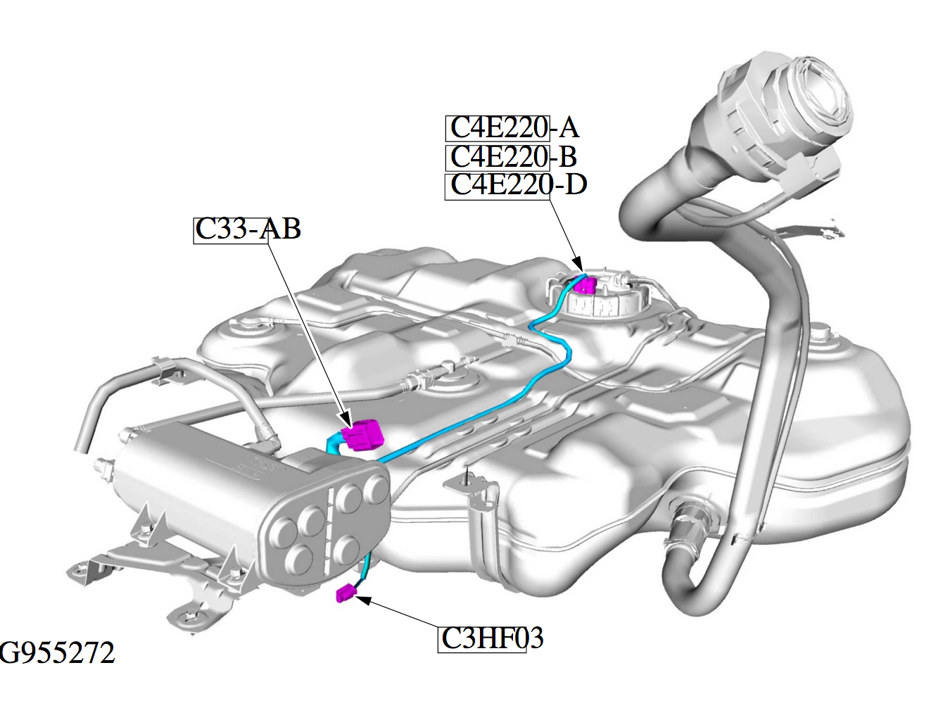

    After some googling i am certain the problem is the cable from the petrol pump, 6g9t-14a069.
    Before i am jacking the car up to clean the stecker, i would like to see a picture of the stecker underneath the car, so i know where to look.
    ( not the stecker on the pump, but the other end )
    hope you guys can help.
