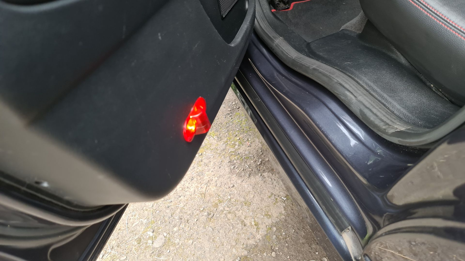

    Been fitting powerflex trailing bushes today . Did rear door ford projector lights to match fronts and also stop and tail in bumper reflectors. Last off fitted DRL in mirrors which change to orange led sweep when indicators are used

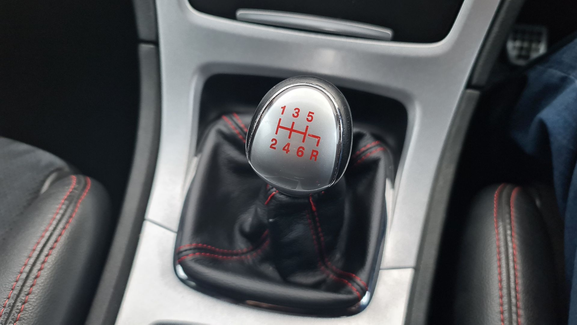

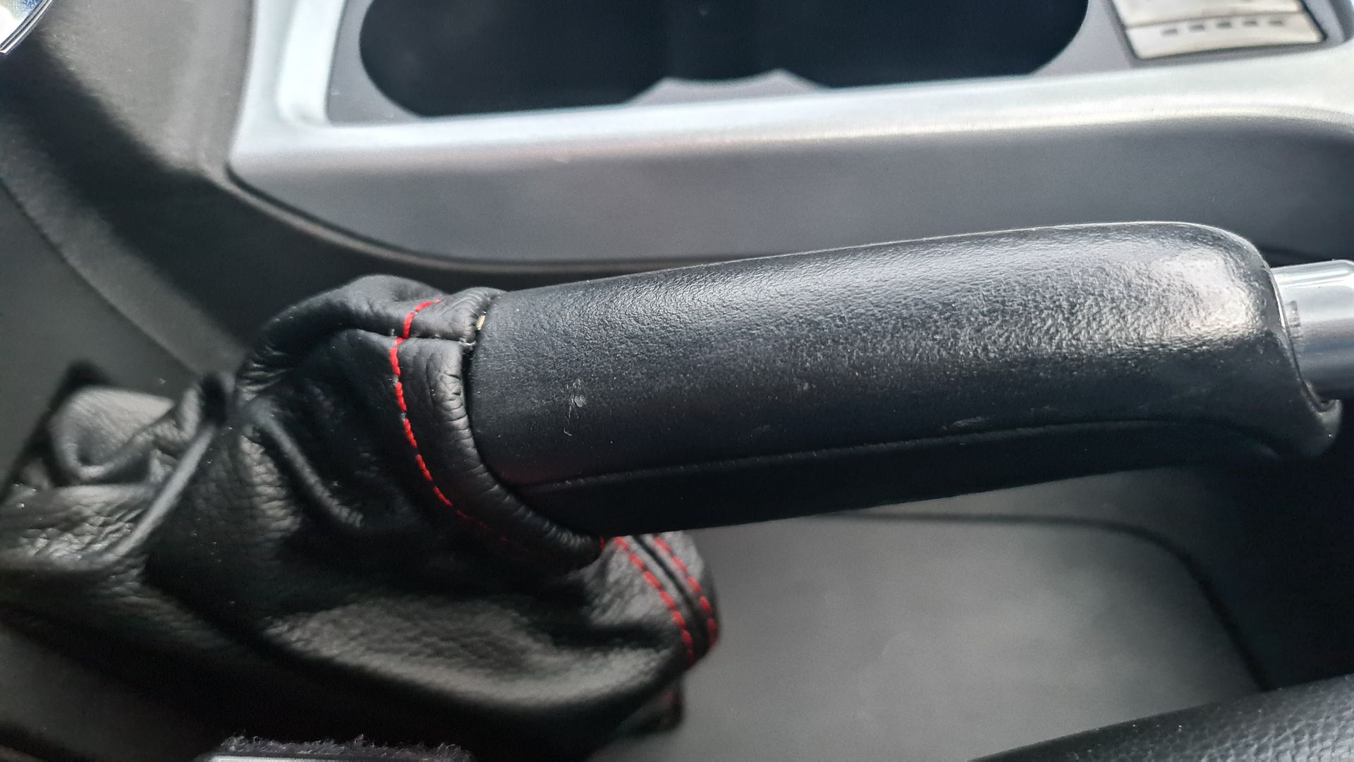

    Oh and new red stitch gaiters on gear knob and handbrake
