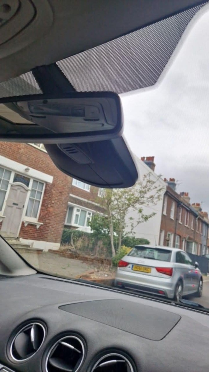

sigh, the rain sensor isnt being detected, so no auto lights / wipers. Any tips?

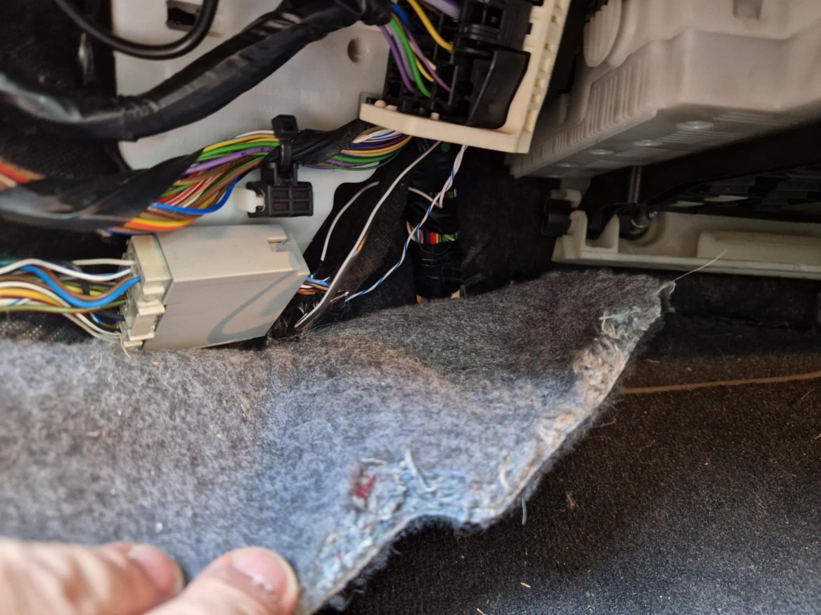

From the camera connector 3 wires ; Can-High (white blue), Can-Low (white) and GND (black white) run along the roof, down the piler to the connection next to the BCM
That grey connector is also for my keyless start - the 3 wires need to be spliced into those as they use the same pins/colour wires
No the wiring isnt finished, that was to test the system works! So white/Black goes to white black , white blue to white blue etc etc

The last part is the rain sensor - its a round type vs the square type. The connector is different (its smaller) so will need to be changed to the smaller one to fit.

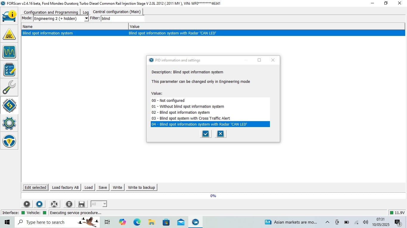

Found the problem!
In FORScan, there is another option
Driver Impairment Monitor - WITH Driver Impairment Monitor.

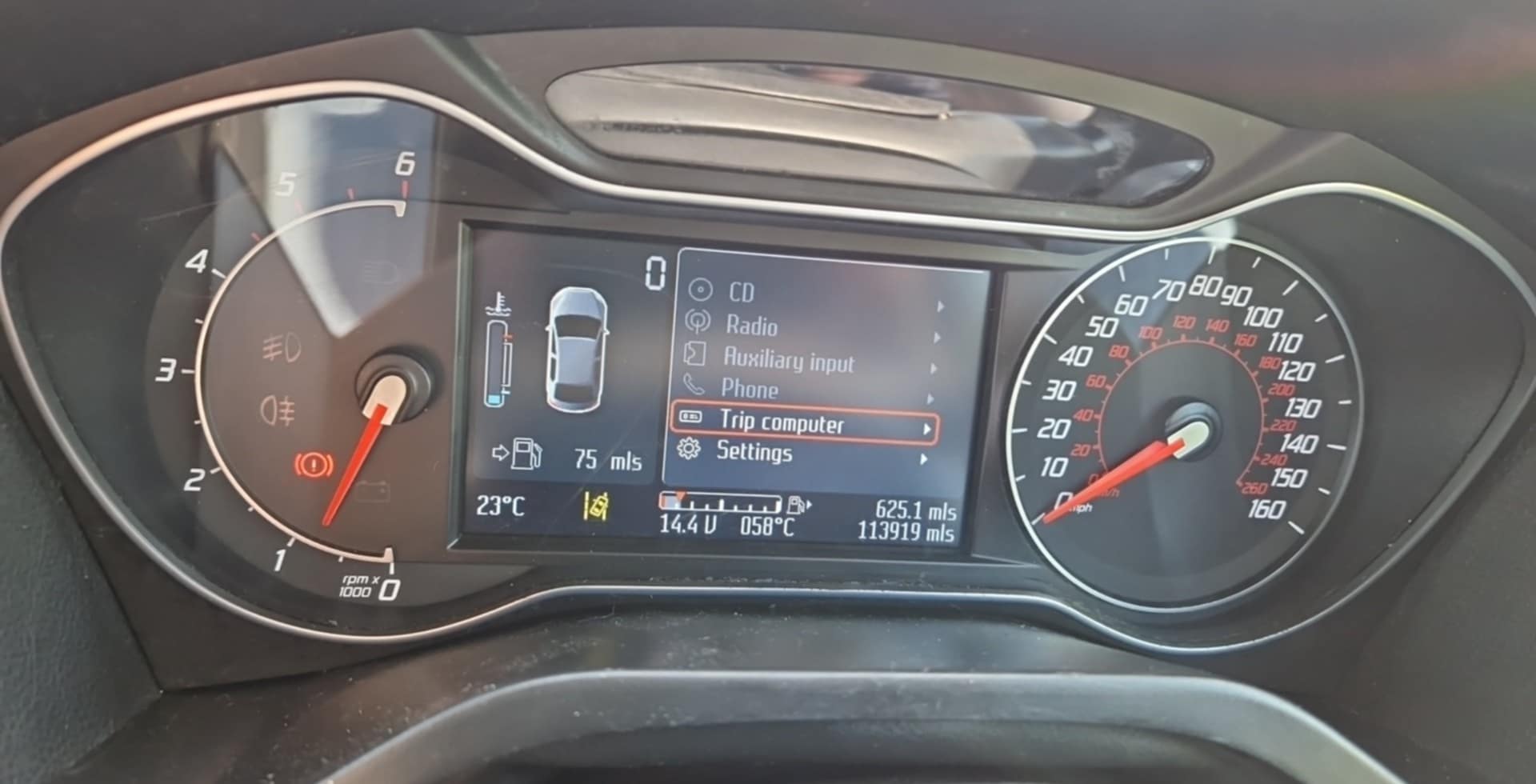

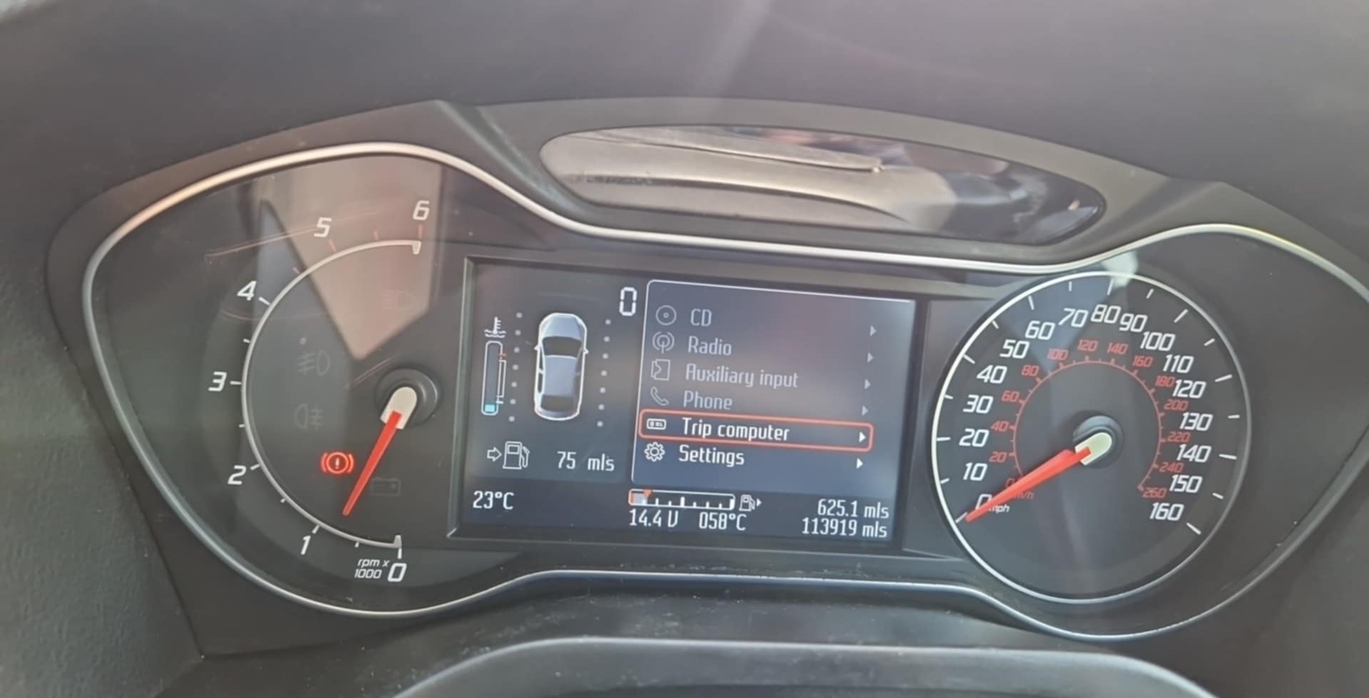

At a loss now as when i press the stalk this happens for a moment
but then turns off

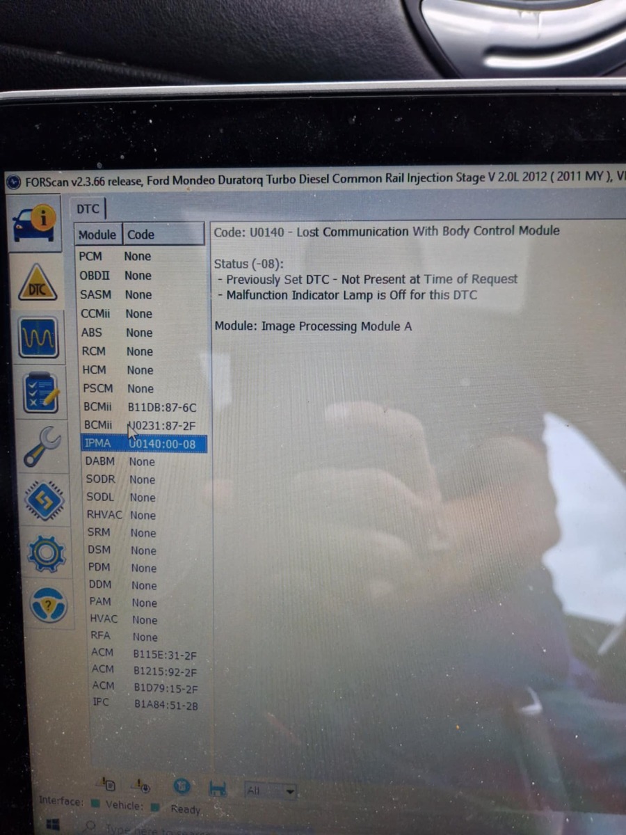

BUT, im getting errors:
and it doesnt have a camera module anyway for rear camera? Not sure whats going wrong - 1 error it for rain sensor as well

The error is U0140:00-8A

Wiring spliced into loom under glove box.
All enabled in Forscan , but , i can turn it on but it goes straight off again with this error.
Help?

Found the problem - its 2 part ! The door modules were not the `correct` ones - now changed for parts ending `VC` and `SC`. Still didnt work. However in forscan, `Blind Spot Mirrors` has 4 options. Thinking to what you said about canbus, i changed the mirrors from ` with blindspot` to `with blindspot with radar CAN_LED` . So with correct door modules and proper setting, i now have the orange dot on the mirror when testing
