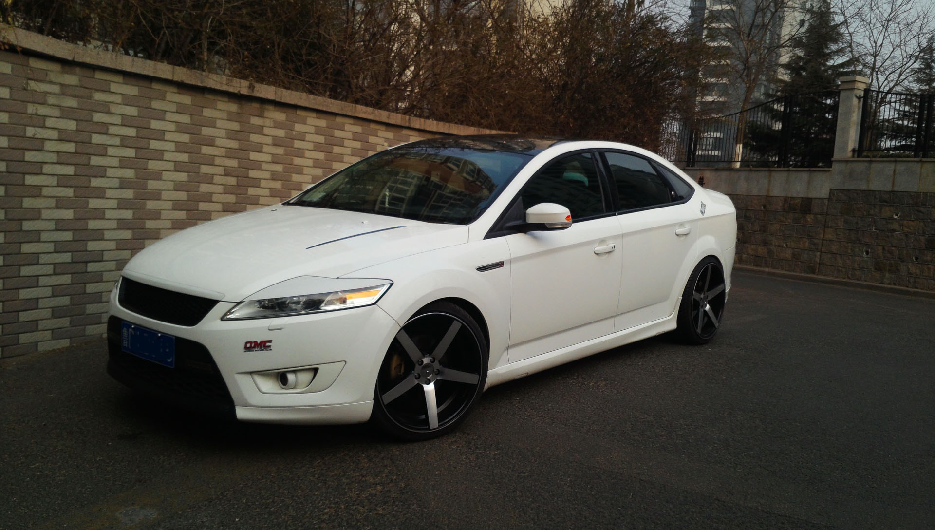

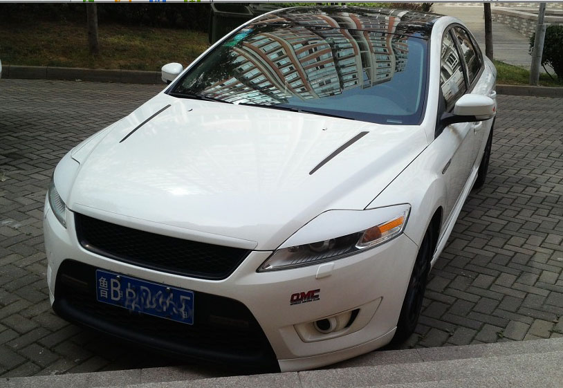

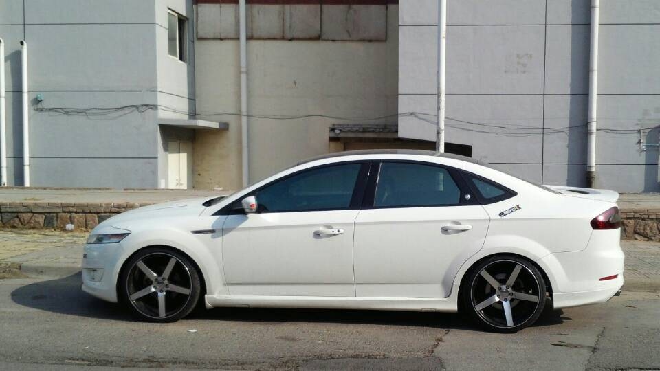

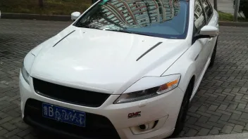

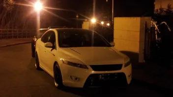

Steve's mondeo with 20 rims mk4 2.3L petrol [china]
  • Der Inhalt kann nicht angezeigt werden, da er nicht mehr verfügbar ist.

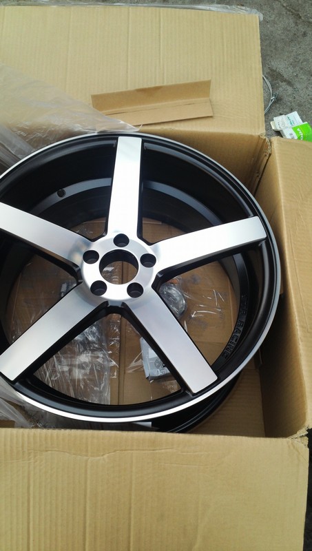

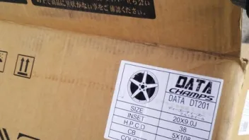

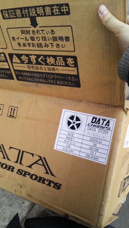

    20 inch replica vossen cv3 rims, et38, 9J, tyre wanli sn3800 225 35 20, HR spring 29065-1

  • Hi Steve from china, your car looks great, yeah. :thumbup:
    And it was the right decision to take the 29065-1 springs !

  • Your car is looking pretty neat and clean, good job! It's a bit European style which I believe is unusual in China. Only the tyre size is exceptional for Germans because we would use 235's or more on a 9 inch rim. Did you use adaptor plates to make the wheels fit into the arches or is this directly achieved with the offset of the rims?

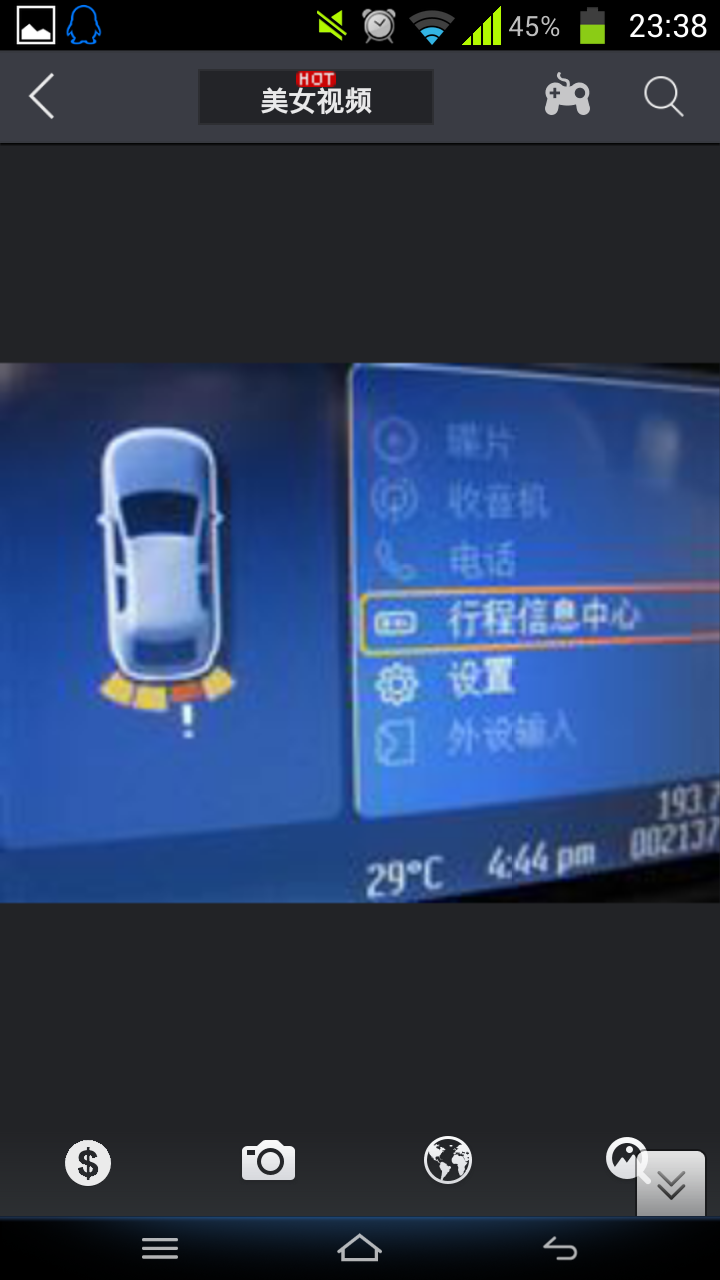

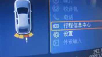

  • Nice car! I would like to know if you got PDC-visualization on your Convers+ display?

    many thanks for that! i have been working on my car for couples of years. i have tried 16 17 18 19 inch wheels in the past and decide use 20 inch one for now.Only 2 mondeos use 20 inch wheel in china at this moment. the first one looks weired in my view.235 will be good but i cannot find cheap tyres for them so i use 225 35 20. the tyre is so cheap which you may not believe. only 40 euro each. i may try 245 in the future.
    i was using 15mm adapter on the rear wheels but they look not very good and they do make tyres touch the arches sometimes. so i get rid of them now. et 38 is good for my mondeo for now,

  • I mean, if your park distance control is on, are the distances shown on the convers+?
  • Ein Herzliches _Welcomehier142_ im besten Forum der Welt. :thumbup:
    Bist du ein Chinese oder Eingewandert?
    Replika Vossen Felgen kann es nur in China geben. 8|
    Aber schick sieht er aus. Gefällt mir.

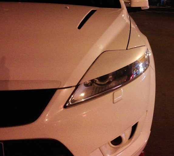

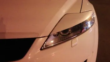

    Der böse Blick könnte mir auch gefallen.

    im a chinese. mondeo mk4 owner.there are lots of replica wheels in china. most of them are good quality. my cv3 are good, very good on balancing machine. i made the evil eyes by myself but got the idea from here.

  • yes pdc is on the conver display
    I am kind of jelous. Only on Chinese (and japanese) markets convers has this cfeature. On mine it is only acoustic and rear pdc is shown on rear view camera.
  • That's what I meant!
