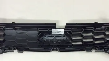

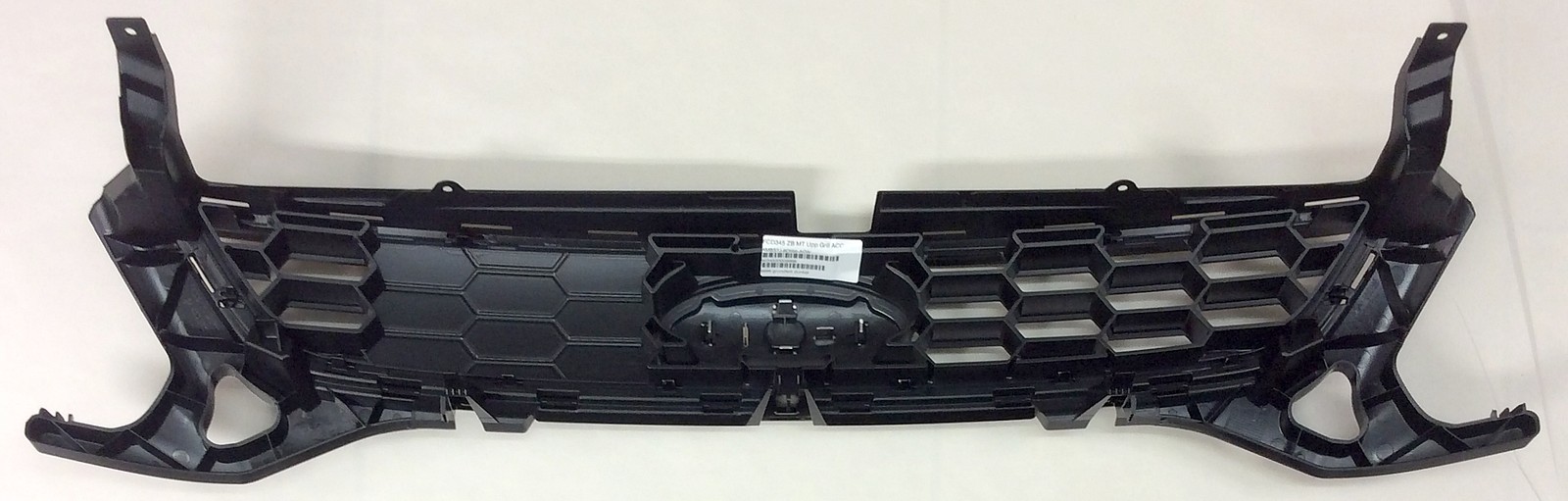

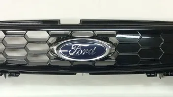

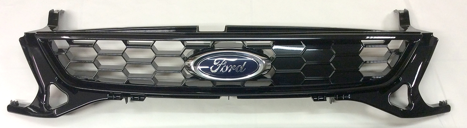

  • This should not be a problem at all. As you can see the grill (for example from an Tit S) with ACC cover has nothing special:
    It is more to prevent dirt and stone hits from the radar unit itself. If you place a plastic behind the grill yourself, it should do, Optics is another story, though ;)
