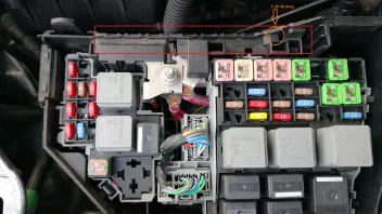

The relay works fine, tested with ohm meter.
With engine running i tested RB1 half pulled out: left pin and upper pin, no lamp on these two, isnt that wrong?
Neues Benutzerkonto erstellenThe relay works fine, tested with ohm meter.
The relay RB1, has power on one pin without ignition, and only on the same pin with ignition.
i pulled RB1 halfway out, with ignition, and put the lamp on the opposit pin, but no light?

[Blockierte Grafik: https://imageshack.com/a/img923/3599/hK9Vif.jpg]
the big one makes click when pulled in/out with ignition on. the small one does not

F17 - F21 all give light in test
a few of the DTC codes have 'not available at time of.. '
Yes, i pulled the fuses out, and did not get any light with test lamp on the fusepoles
i did check F17 - F21, all fine..
Thanks for your input guys!
I checked the fuse FB1 in the rear compartment, it was ok.
Then i put on the ignition, and put a testlamp on the poles of FB1: nothing
Also tried some other poles near FB1, still nothing.
Any clues?
