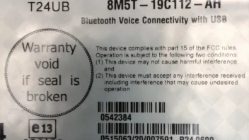

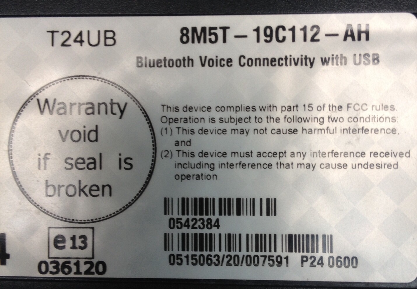

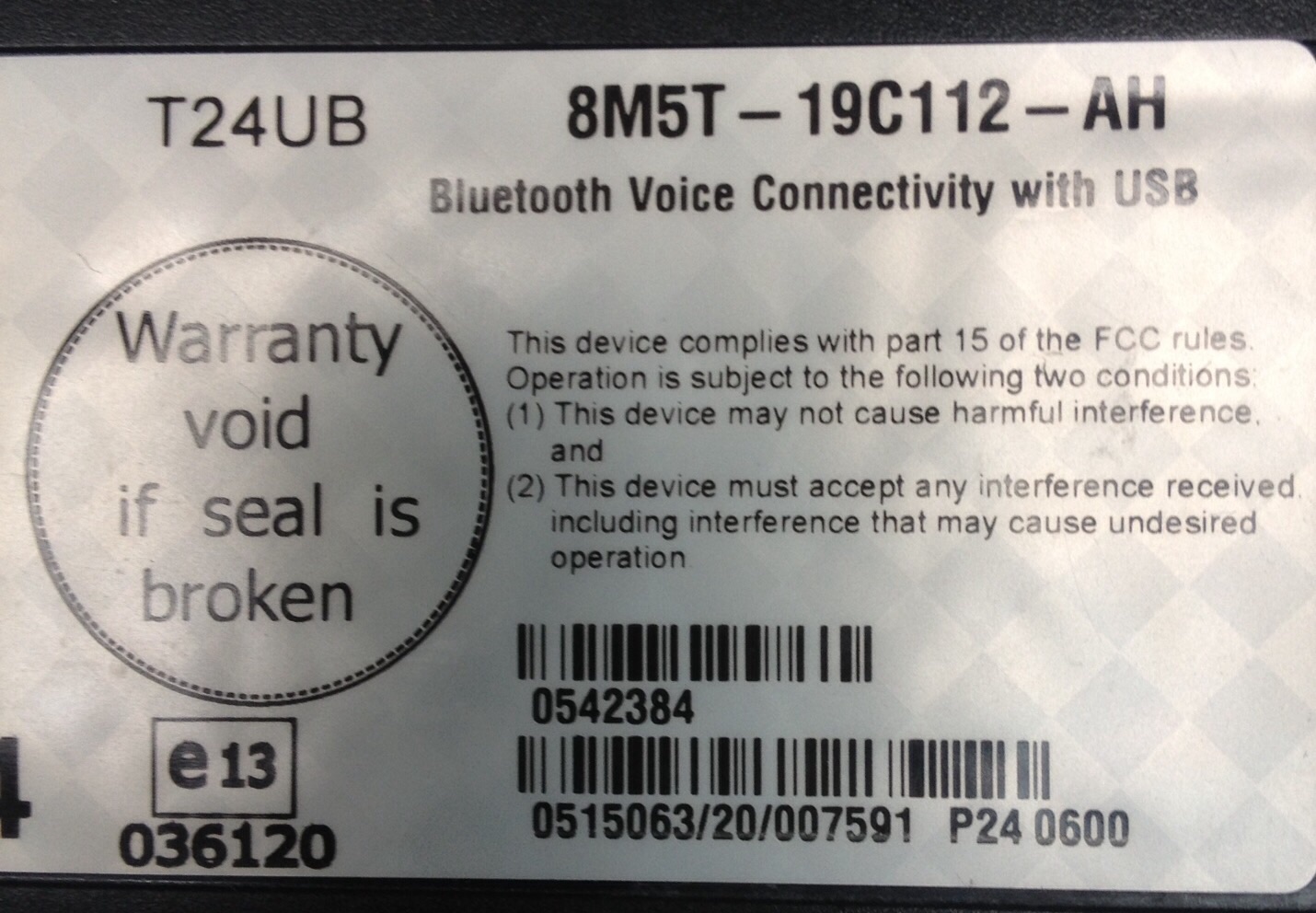

    Here's my problem. My previous BT/VC module was a 7S7T-19G488-BE, German language.
    I installed a 8M5T-19C112-AH, supposedly English, but the voice control is still in German.
    How do I change the voice control language. German isn't a problem for me, but the VC doesn't like my accent. X( Help!!!
  • The Blaupunkt FX has no control over the voice control language only the menu language.
  • That's right but no fault by the Radio/Navi but the version of the S&C module itself. Only Modules starting with built year 2010 have mutiple languages that can be selected via menu. Modules with part numbers beginning with 7, 8 and 9 are working in one fixed language only. The last but one digit denotes the language of the module, A for english, B for german, C for french and so on. No way to change that (other than swapping the module) or to use more than one language.
    In your case, something is wrong with the supposedly english module. Where did you get it from? Is it possible that the part number is a fake?
  • I bought the module from here last year. The seller is no longer a member. The label looks real. ?( Could be from another module. It does have streaming audio :D:D , which is supposedly available after version M. The label says version H.
    Is there a way to confirm the module type? Reading the software via the USB?
