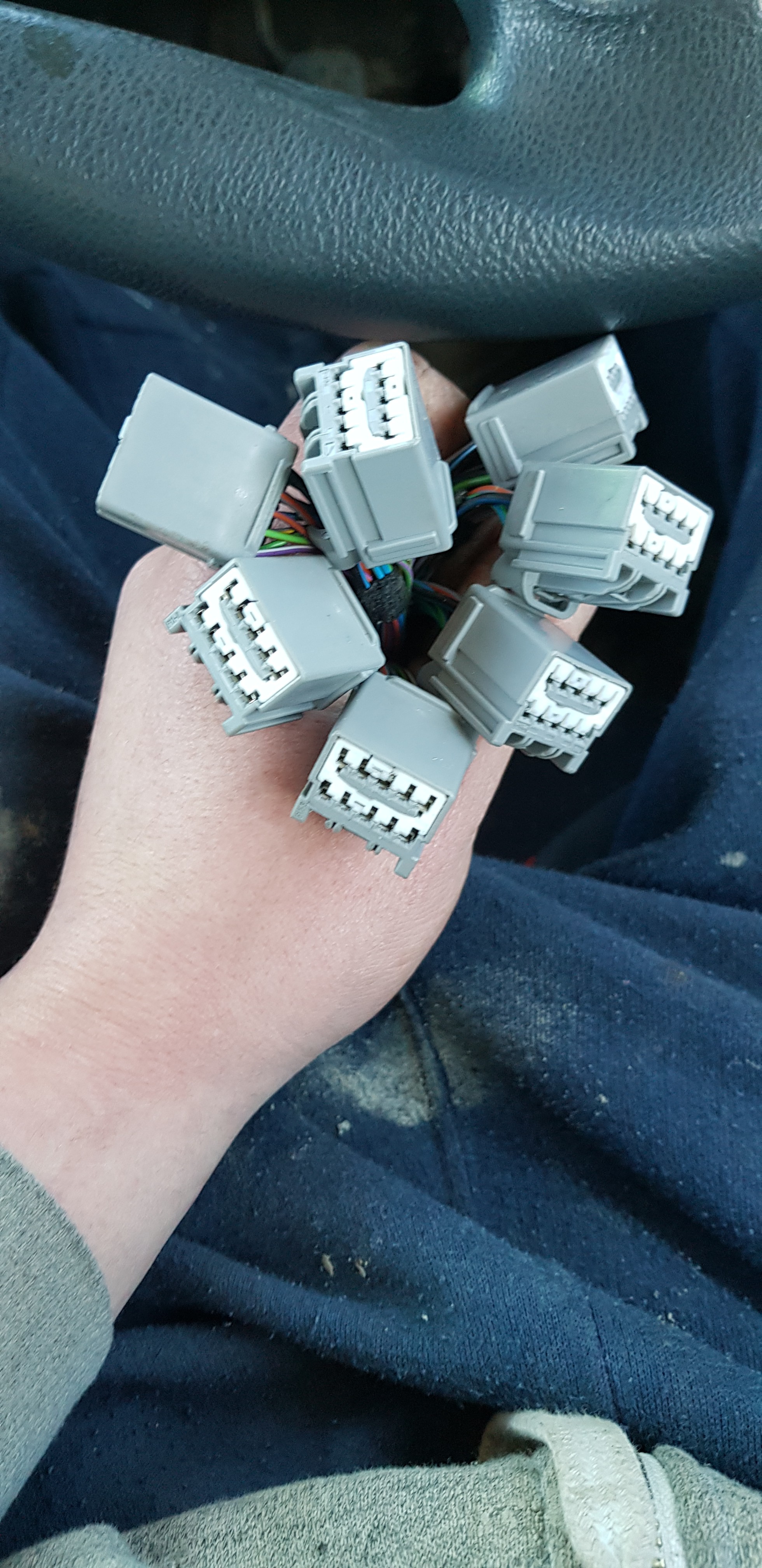

  • I have researched this a while ago with a guy on talkford.com, and there is whether a marking, nor a manufacturer on the plug. Best way is to reuse some similar plug, because it is widely used on other locations in several Fords abd Volvos. E.g. in the tailgate harness or the side mirrors of the MK3.

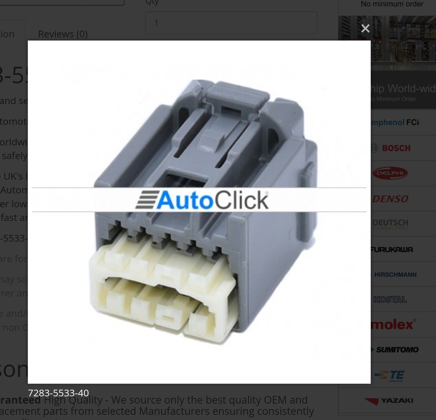

  • I have found it 7283-5533-40
  • comes with pins and seals
  • Yeah, i did found one on an Chinese automotive supplier, but i'm really shure it is originally from TE or another brand, and not really from YAZAKI...
    Where did you found it? And what's the price?
    BTW: Besides the MK3-Mirrors plug and tailgate plug, you could also use one from Volvo S60 MK2 heating blower with part number: D-31327423-001 (which you can order).
  • Great, price seems ok, if someone can't get his hand on an junkyard harness or so...
    Still wondering if Ford really uses "Yazaki" connectors.
