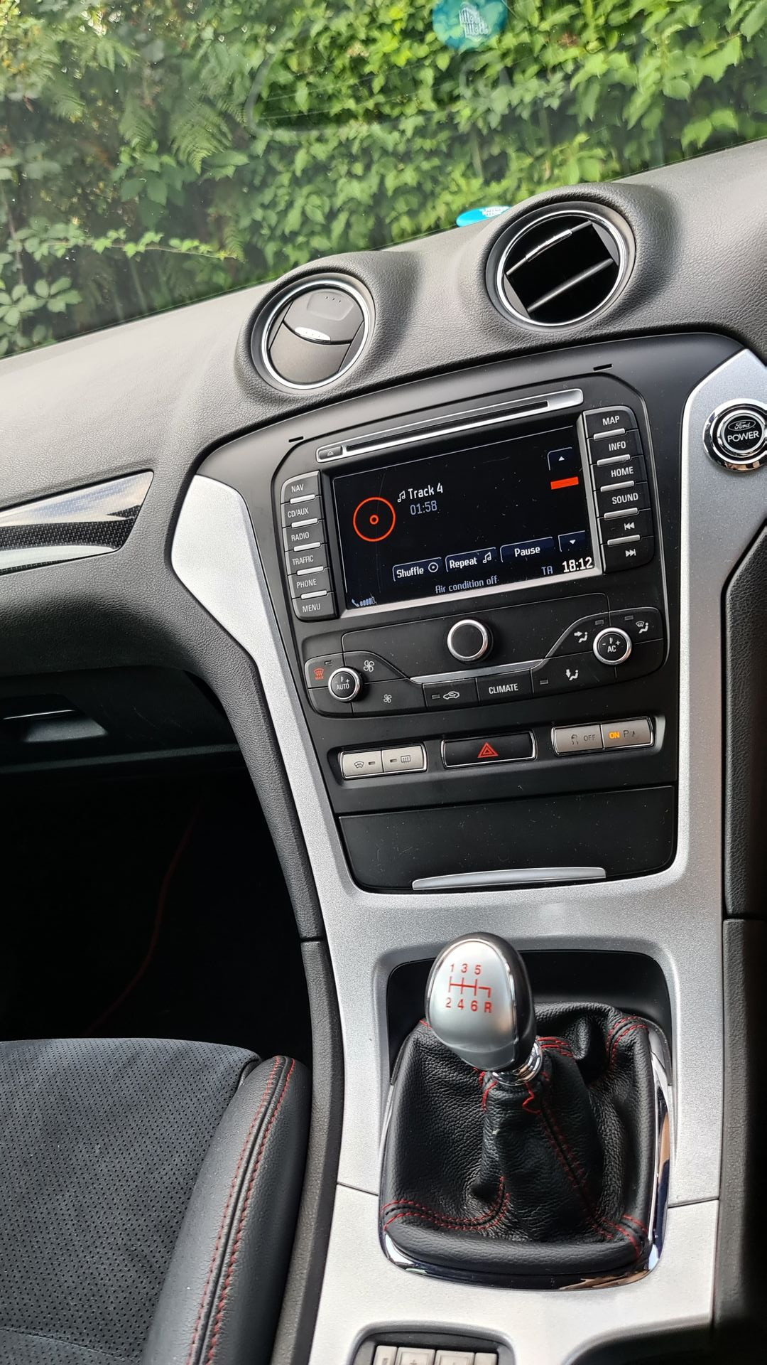

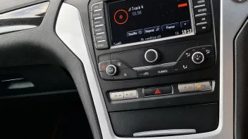

  • looking for help with DAB activation on MCA head unit. I have fully upto date MCA in my 09 plate mondeo 2.2 TXS estate, everything currently working I clouding rear camera. However DAB isn't showing g on head unit or converse plus. DAB control module I stalled with connection look but cannot activate in elm co fig, stereo se lectionary is not highlighted so I cannot select high stereo with DAB, cd changer etc.

  • yes MCA head unit, I fitted it also retro fitted rear camera . Everything works , I have made adaptor loom and fitted the DAB control module. Just cannot get it recognised in config. So annoying as convers plus is modded now, all modules updated ?

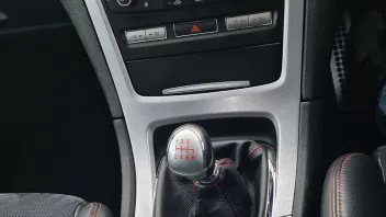

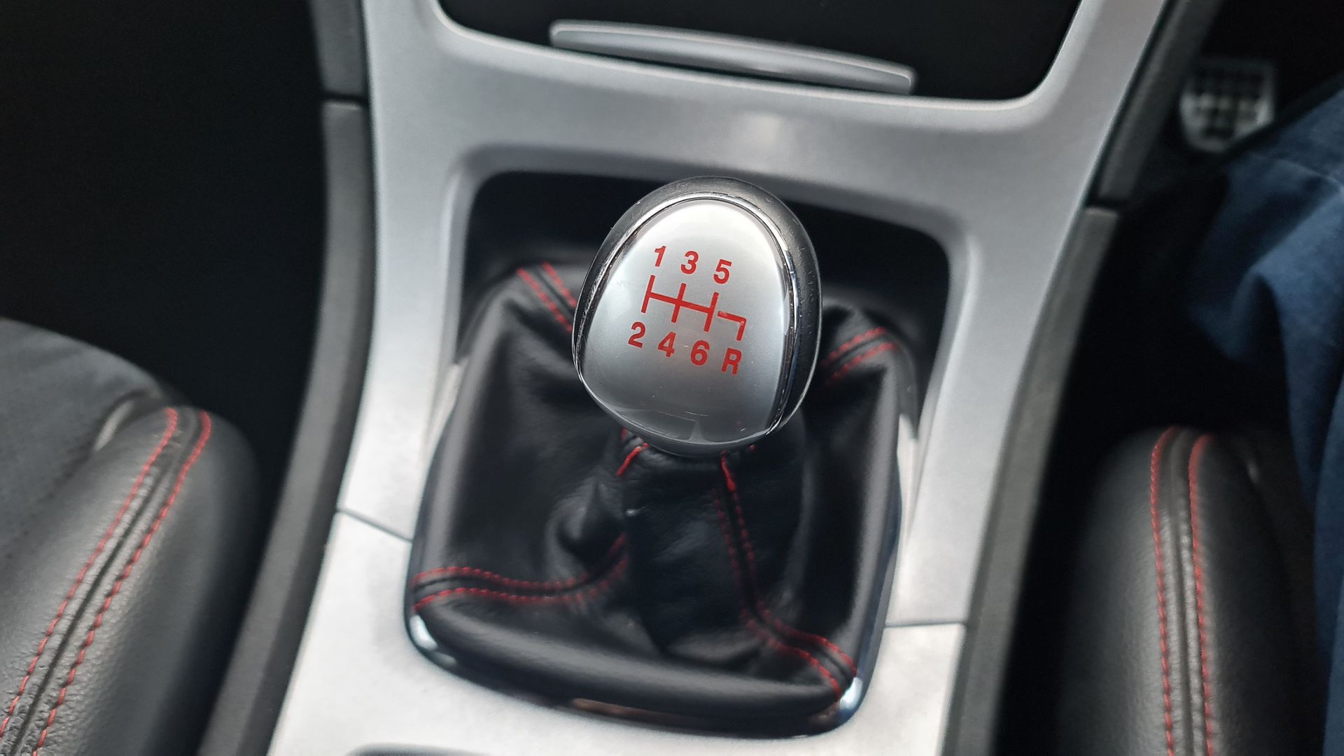

  • GO4IT

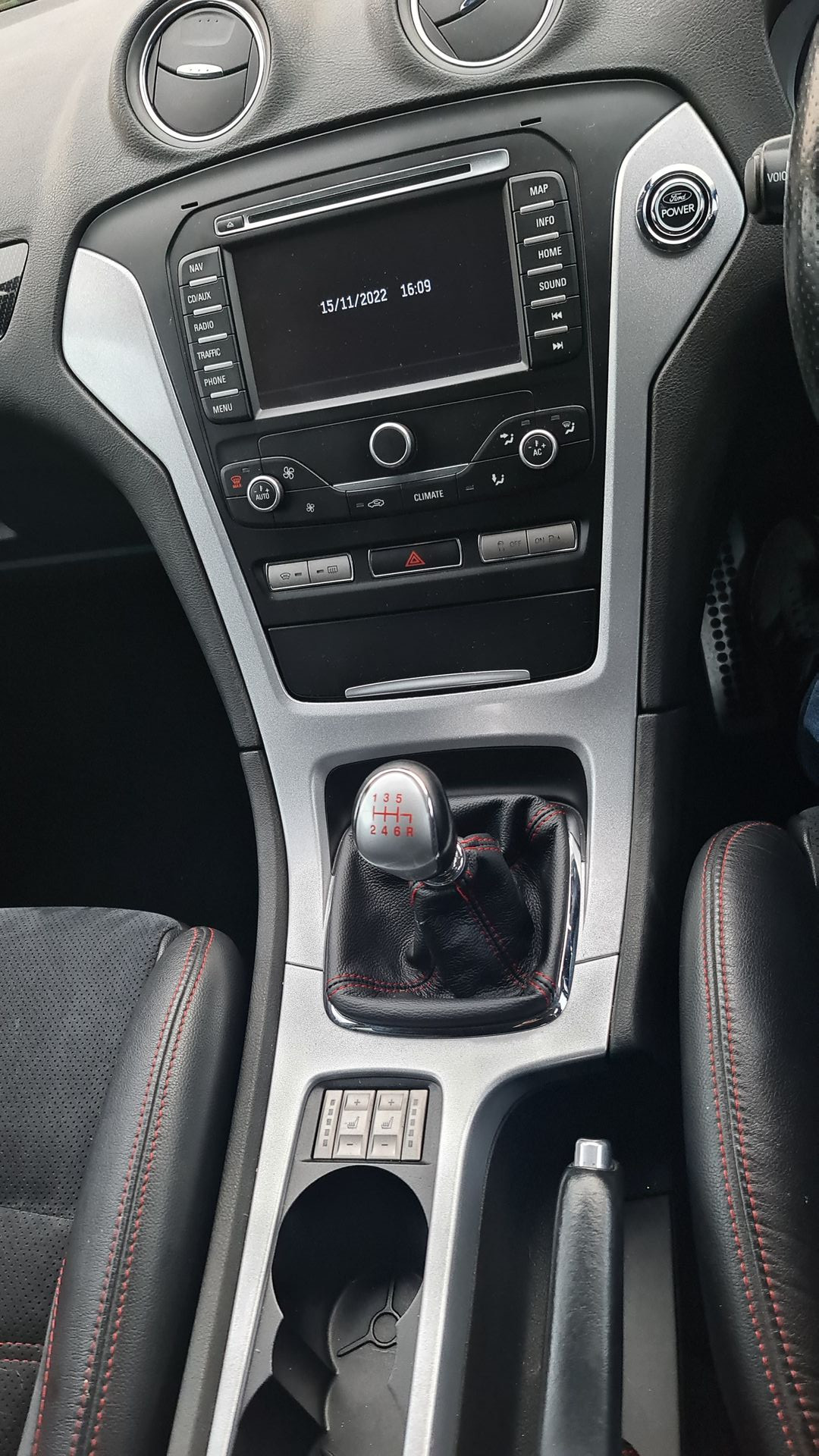

    Thanks for reply as above deffo MCA bit of a potch to fit lol changed arm rest console and cup holder trims etc as different to my early mk4.
    Looks nice now finished in sparkle silver as on alloys looks nice in sun and when orange ambient light hits metallic.

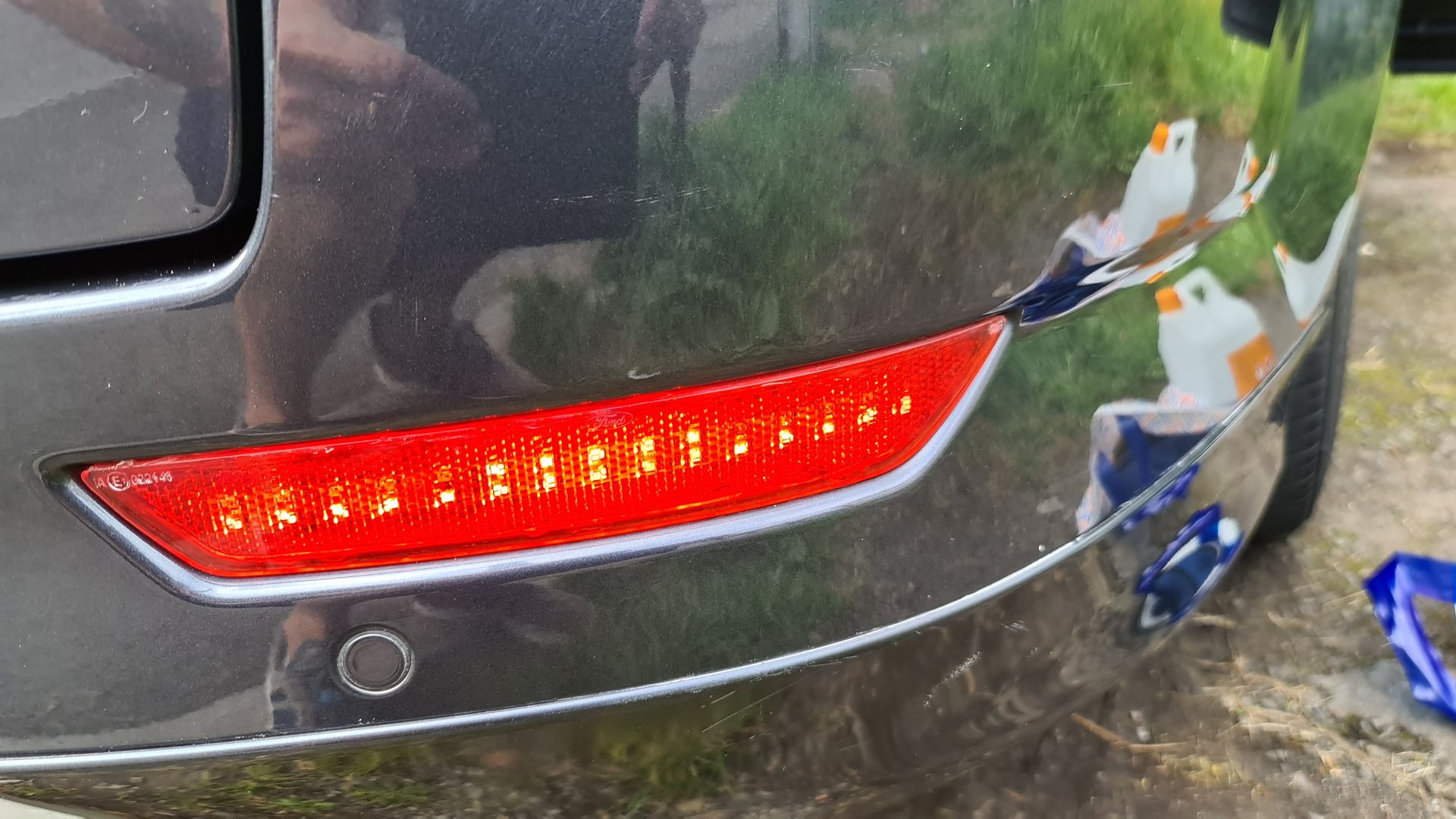

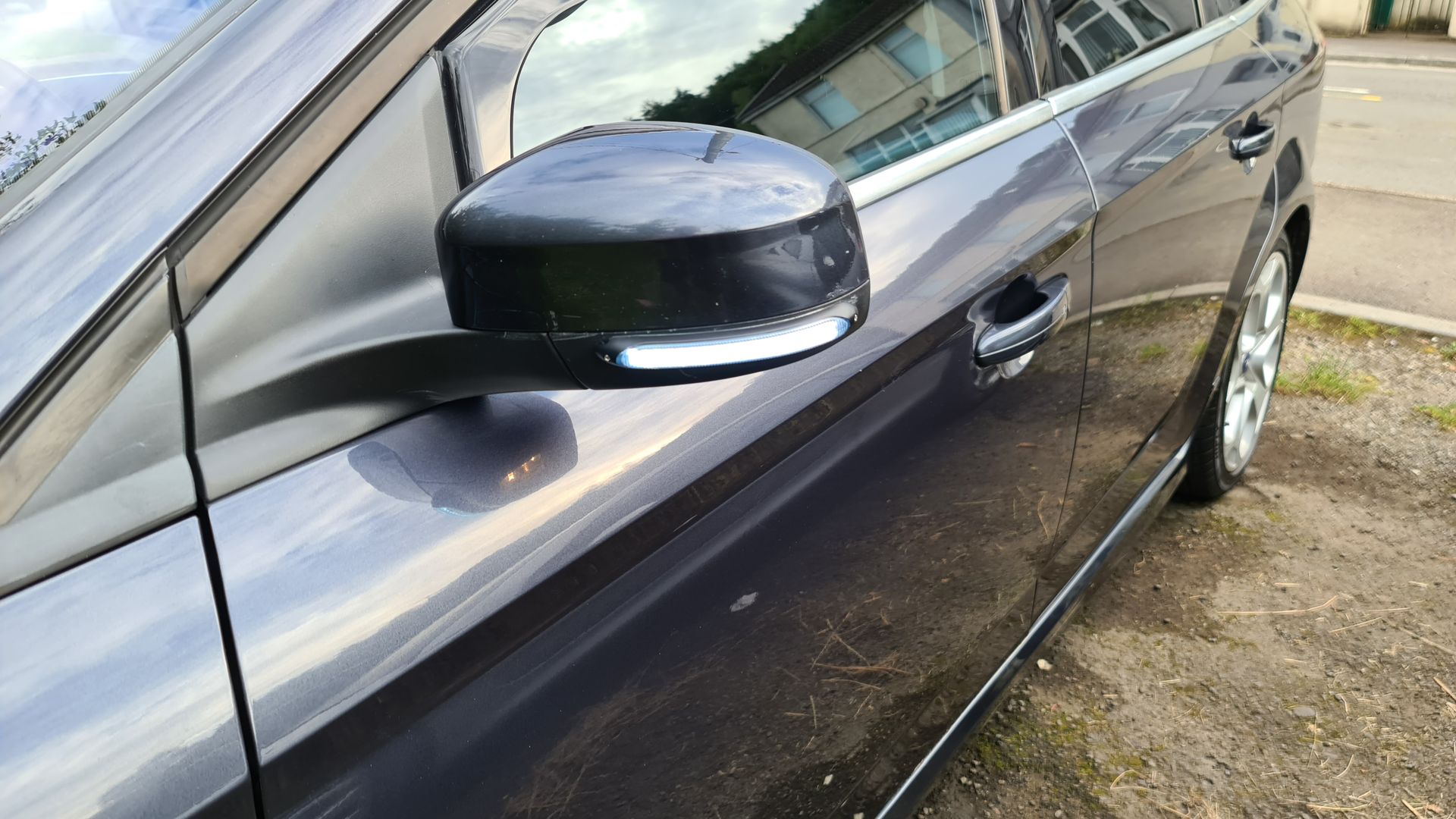

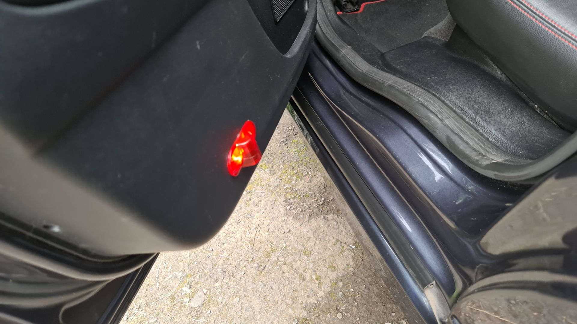

    Been fitting powerflex trailing bushes today . Did rear door ford projector lights to match fronts and also stop and tail in bumper reflectors. Last off fitted DRL in mirrors which change to orange led sweep when indicators are used
  • GO4IT

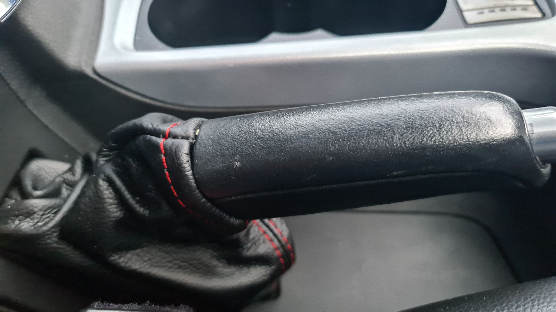

    Oh and new red stitch gaiters on gear knob and handbrake
