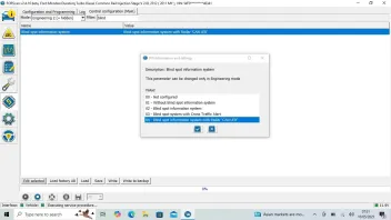

here you go
Blind Spot retro fit

Interesting. I personally never did codings with Forscan, always used ElmConfig for that and in there, there is no such option. You can only turn it on and off
Maybe the "with" option set the value "04" but does not offer the other options not used in our Fords.
YES, found it. The value ELMConfig writes into CCC-Byteposition 0x024 is 0x04 if you choose "With Blind Spot" and so matches the ForScan setting "Blind Spot Information System With Radar 'CAN LED'", which seems to be the original label from Ford. ELMConfig is simply don't tell the other options as they are not relevant for Mondeo/S-Max.
I've added this to the Wiki.
