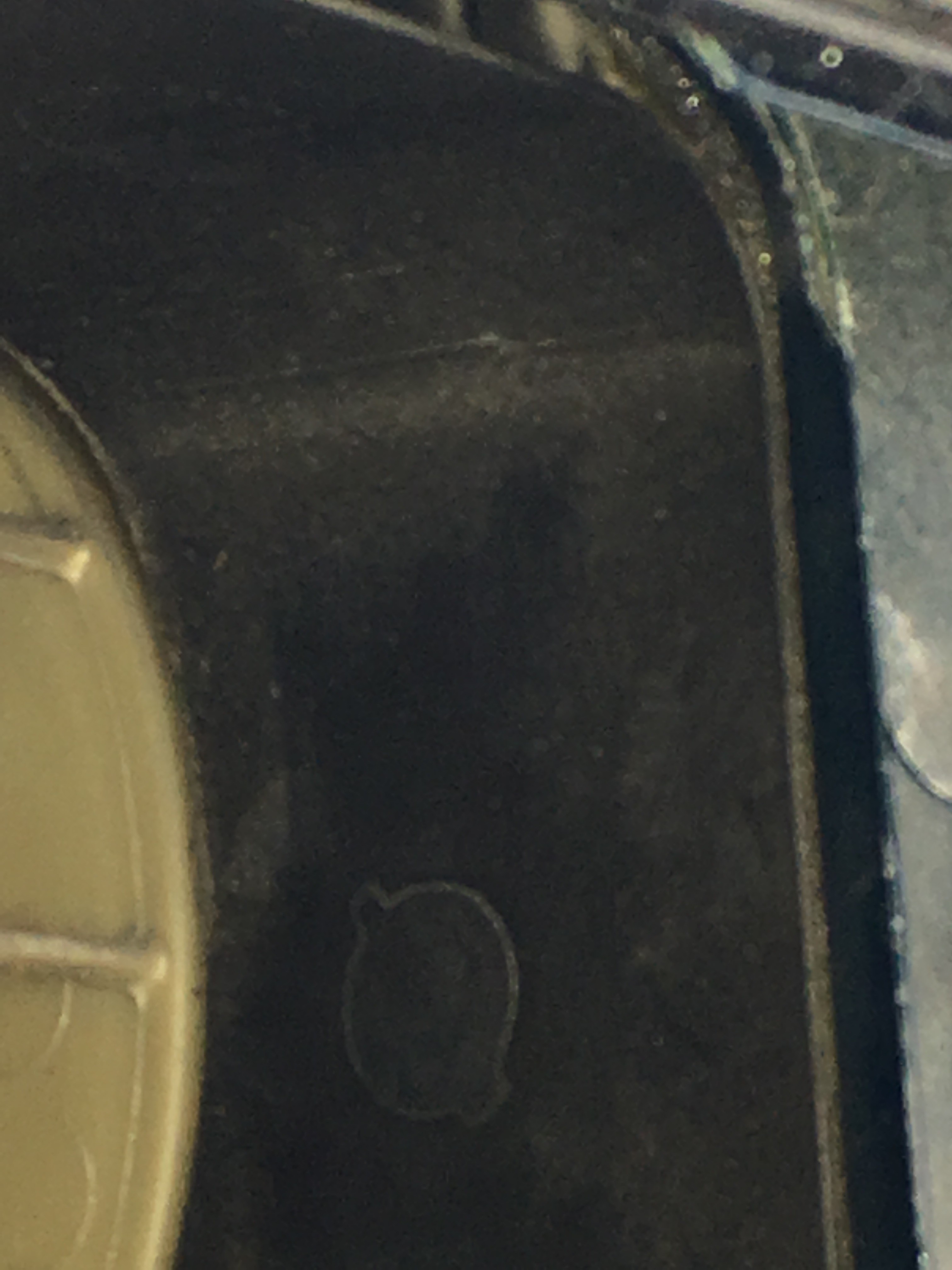

I have just started to fit one of these sensors. It was never available for RHD, only LHD. But a bit of information if anyone is interested. The hole for sensor is marked and can be drilled from outside car. Still a bit awkward but much easier than doing it from inside.
[Attach = 24555] [/ attach] Here is cut-out, with locating tab markings. ThisIs on my RHD
[attach = 24554] [/ attach] You can just about see the mark on Thispicture from page 5
