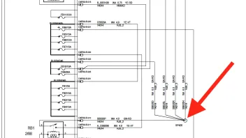

    I checked the fuse FB1 in the rear compartment, it was ok.
    Then i put on the ignition, and put a testlamp on the poles of FB1: nothing
    Also tried some other poles near FB1, still nothing.
    Any clues?
