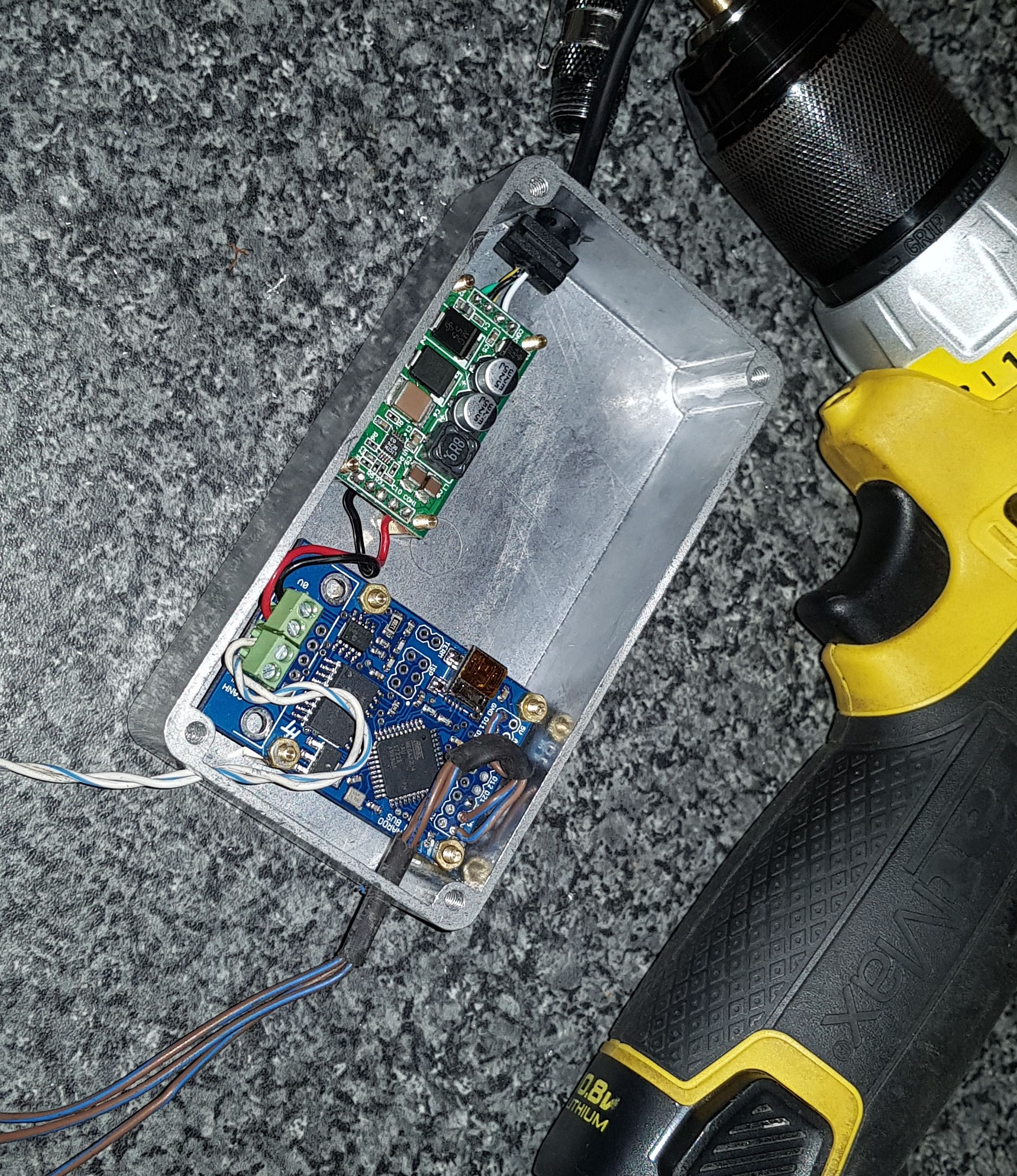

  • I need it for an alarm module I need an ignition live too tell it ignition has been turned on, I guess I will just have to probe around too see if I can find one,
    I also need a GND when the doors open but I think I will have too add a switch for the GND because I don't think there will be a GND

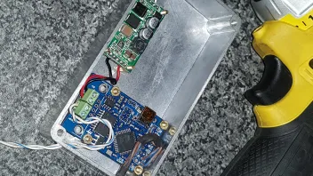

  • I'm making my own keyless entry with ardunio Leo canbus board and got my sketch sorted alarm module is sorted but I need ignition + to put FOB In Sleep Mode To Save It's Battery And The GND Is For The Door So When You Open The Door It Will activate The Keyless Fob Again Then When I Walk Away From The Car It Will Lock Ect
    I have just finished putting my ardunio in a project case
  • looks like I may have too make another ardunio project too recieve ignition on and off cmds and switch a relay
