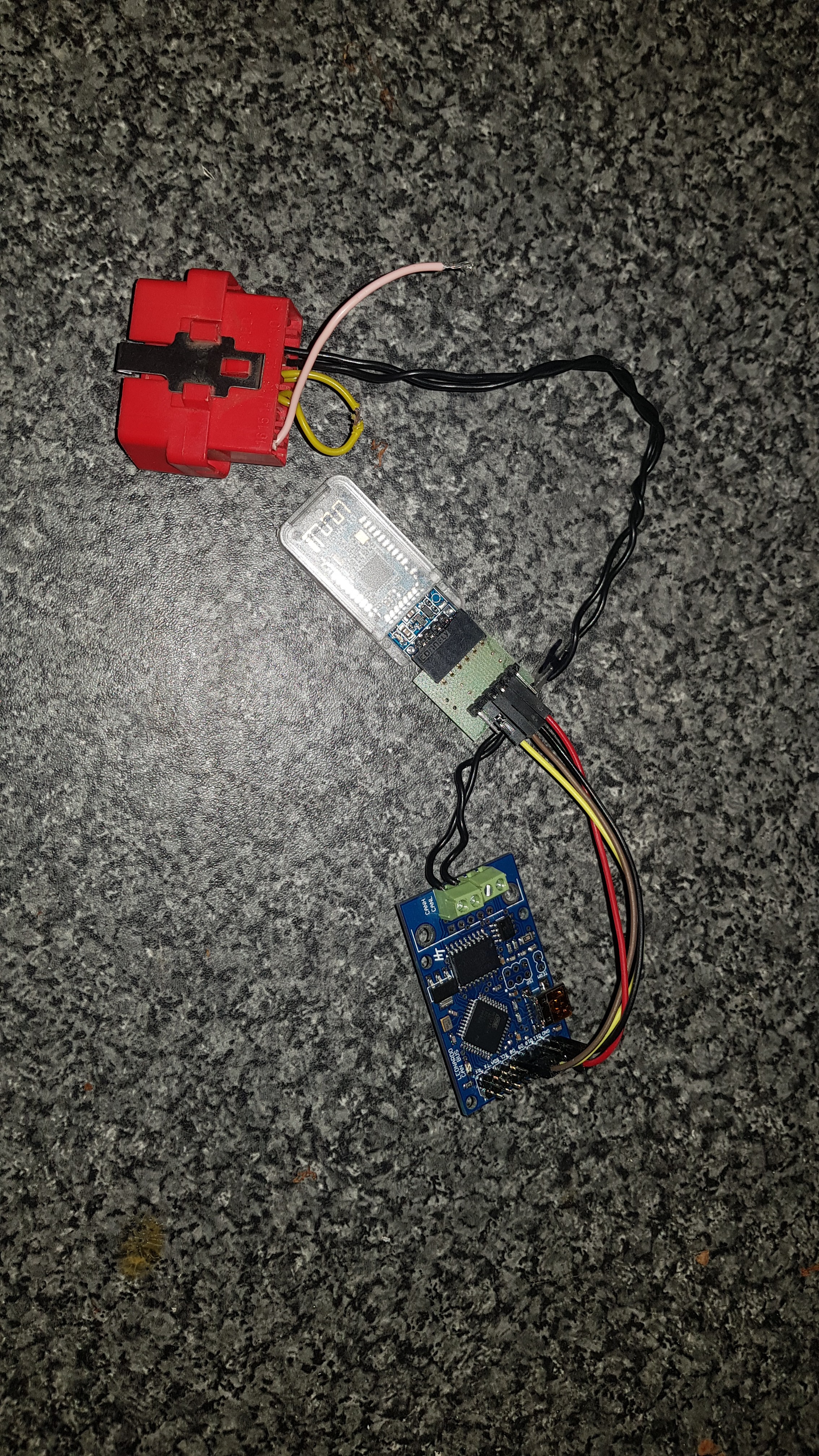

with help from a friend I now have my own keyless entry I took the time to log the ms canbus and found the ID for the RFA module and the data needed to lock and unlock the car via sending canbus messages, (I had to go through many logs until i found the data I needed) I have used a ardunio Leonardo canbus board and a genuine hm-10 BLE bluetooth module, and my Samsung gear watch, the sketch consists of searching for devices and when there is a match it will execute the unlock cmd when the BLE no longer sees the device it counts a set device lost (10times) then it will execute the lock cmd which now double locks the car, after some tweaking and adding some extra code to the sketch it so far works flawlessly I have just about got it working right I have videos but can't upload videos to show my project but here's a pic of my project v1 test set up next step is to put this into a project box with a power supply and solder all connections for better reliability

And it's just connected to the OBD Port?!
Looks pretty simple, cool!If I had time, I would try this on my own

the sketch executes the unlock cmd when the device (my watch) is in range,
The unlock cmd is the unlock canbus ID and data that I found after logging the canbus for some time and played the messages back one by one untill I found the correct ones I needed, and the lock cmd executes when the device is not in range, after 10 lost device counters it's then executed, I had alot of help with the sketch as I'm new too learning with coding ect but it's been an intresting project

it works from approx 1 meter from the car so if there is a wall inbetween it won't pick up my watch and unlock my car, it only sends data when the watch is in range and sends data once when the watch is not in range, power management is not a problem as the ardunio and BLE use very little power my car tracker will consume more power than the ardunio, it's always in a state of searching but a bluetooth BLE uses so little power that I don't need to worry about it, if the car was parked up long term I can easily disconnect the ardunio or even better when I wire it to my cars tracker I can disable it via sending a sms to my tracker I can also turn off the bluetooth on my watch if I don't want it to interact with my keyless unlock
