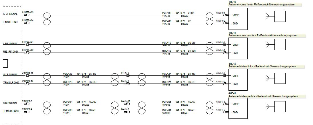

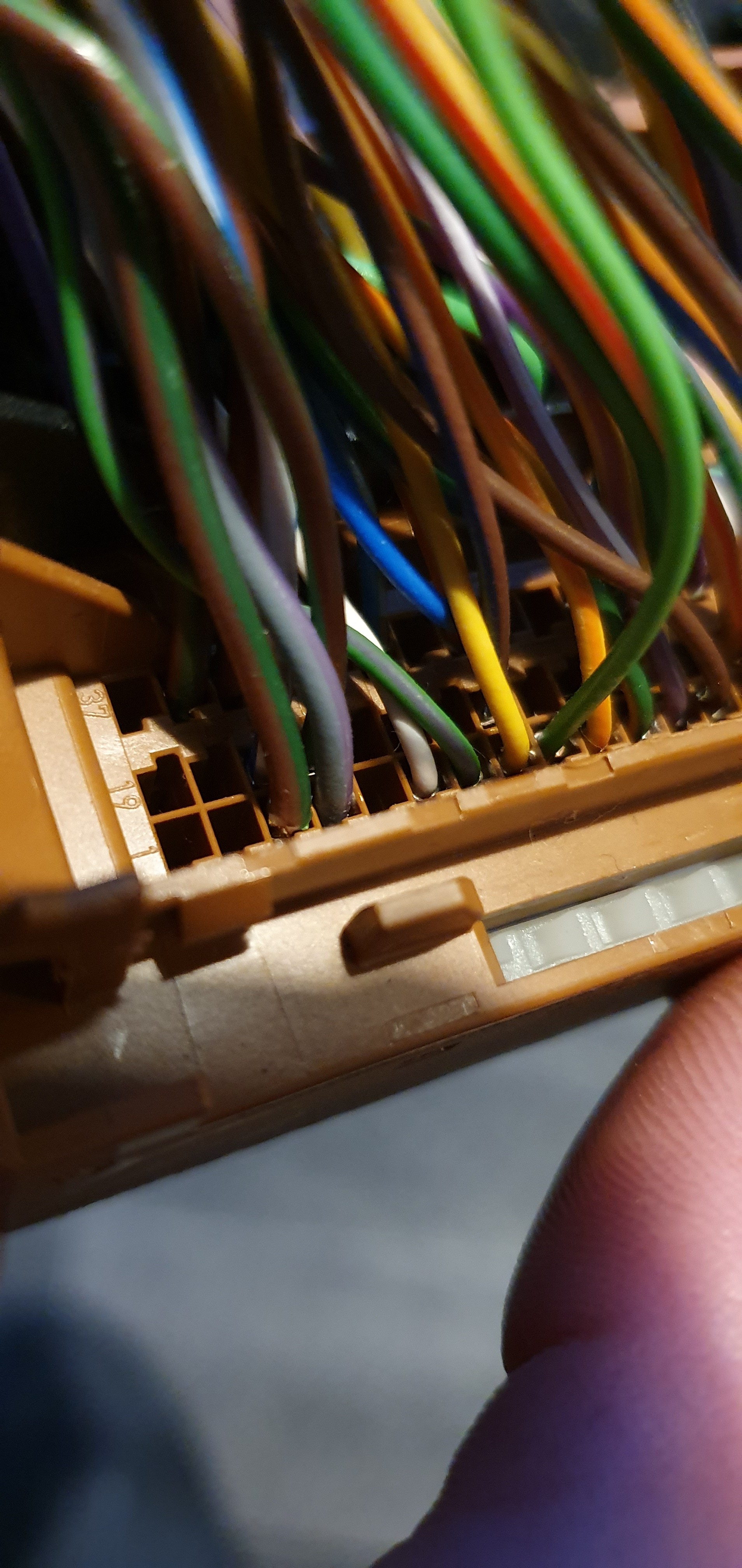

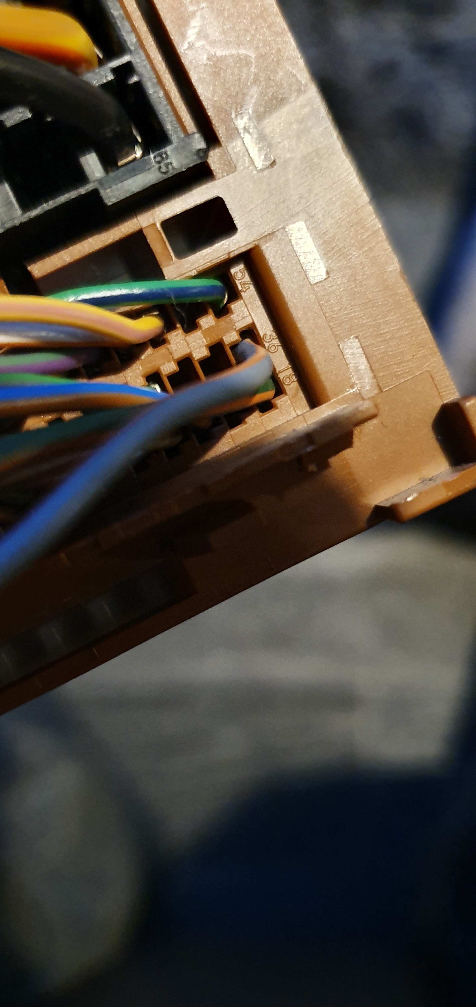

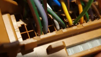

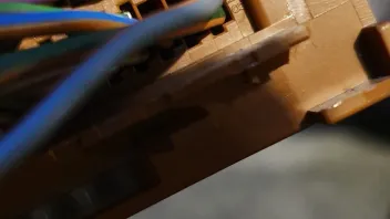

  • I got a plug of a guy that removed the rest of the Tpms stuff and it says on the website hat 19, 20 are one of the rear antenna pins is this correct and been sent wrong plug?
  • I got this plug from a guy who says it came from the car that had tpms
  • Received a wiring diagram from a friend and shows the website is wrong!
  • Maybe mixed up FL and vFL?!
  • There is only one circuit diagram for TPMS in ETIS
    FL and vFL have same pin outs for tpms
  • Corrected it in the wiki.
