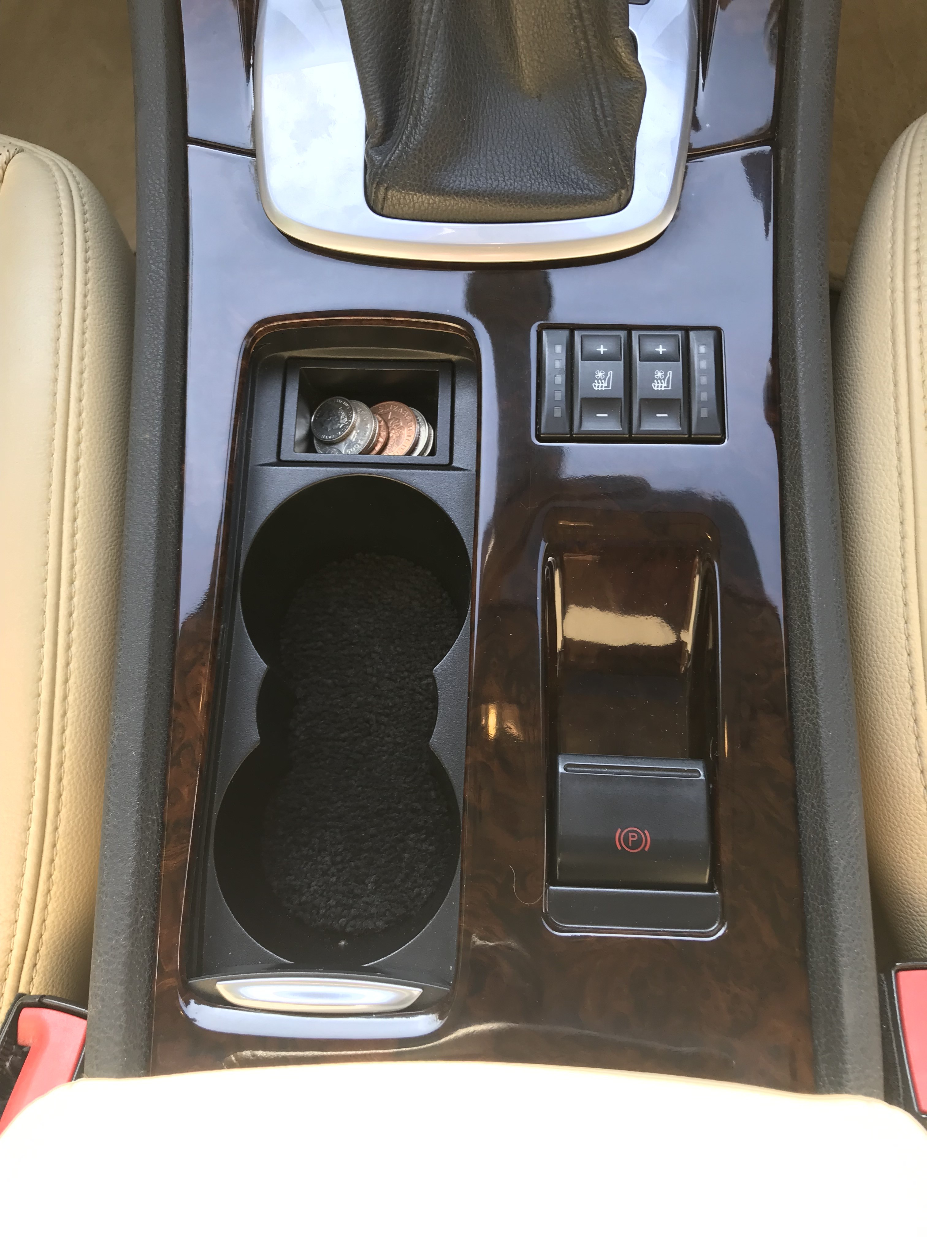

Definitely worth it, for me. A lot of work, but I love it. And prefer my new centre console

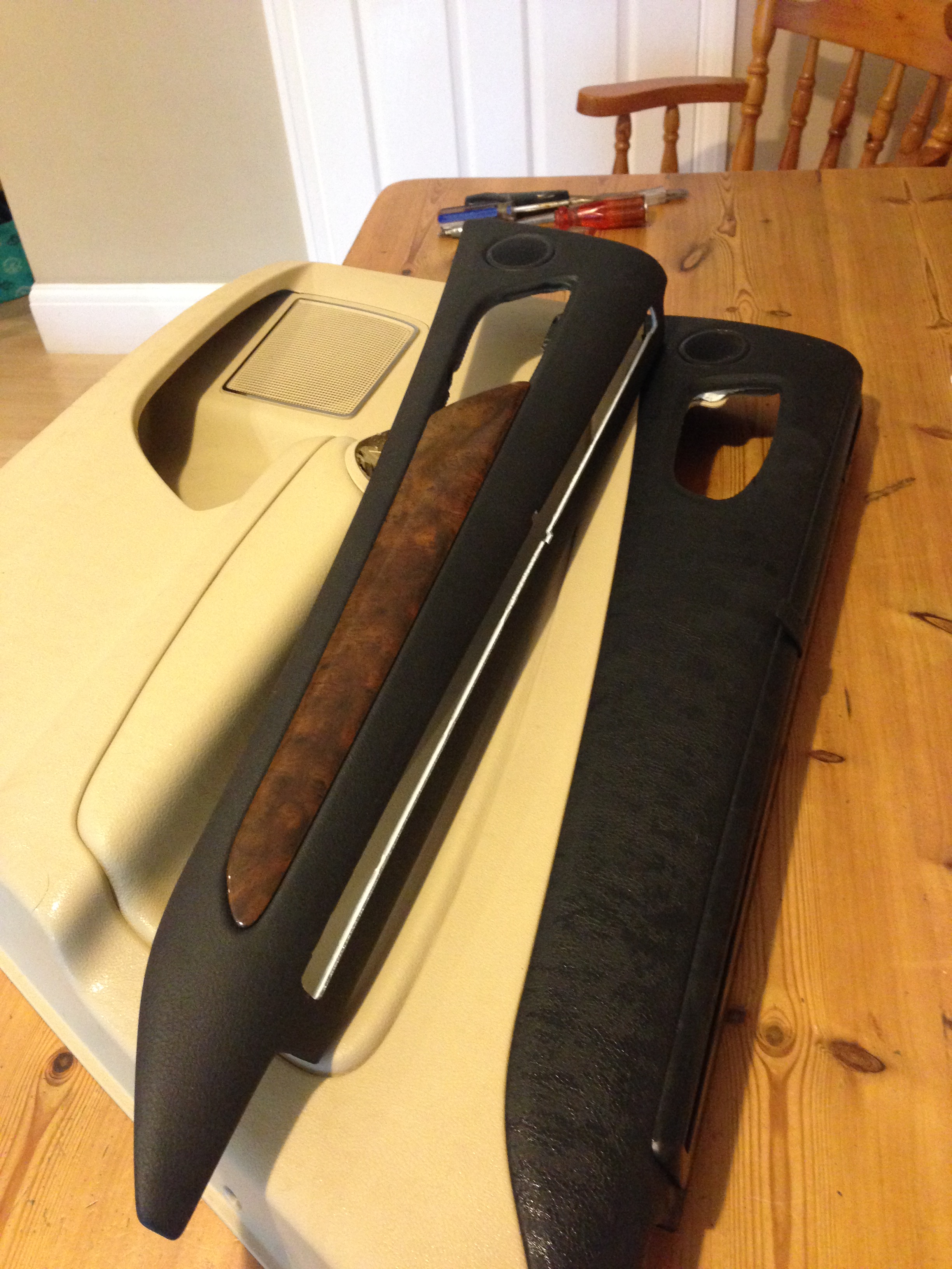

If its any help, you can break off the welds that hold the upper (facelift) panel and fit it to the pre facelift. You can re-melt the fixings and even use screws behind the "spear" to hold it together. Means you don't need to fit pre face handles, which are not very nice. I did this when I upgraded my interior

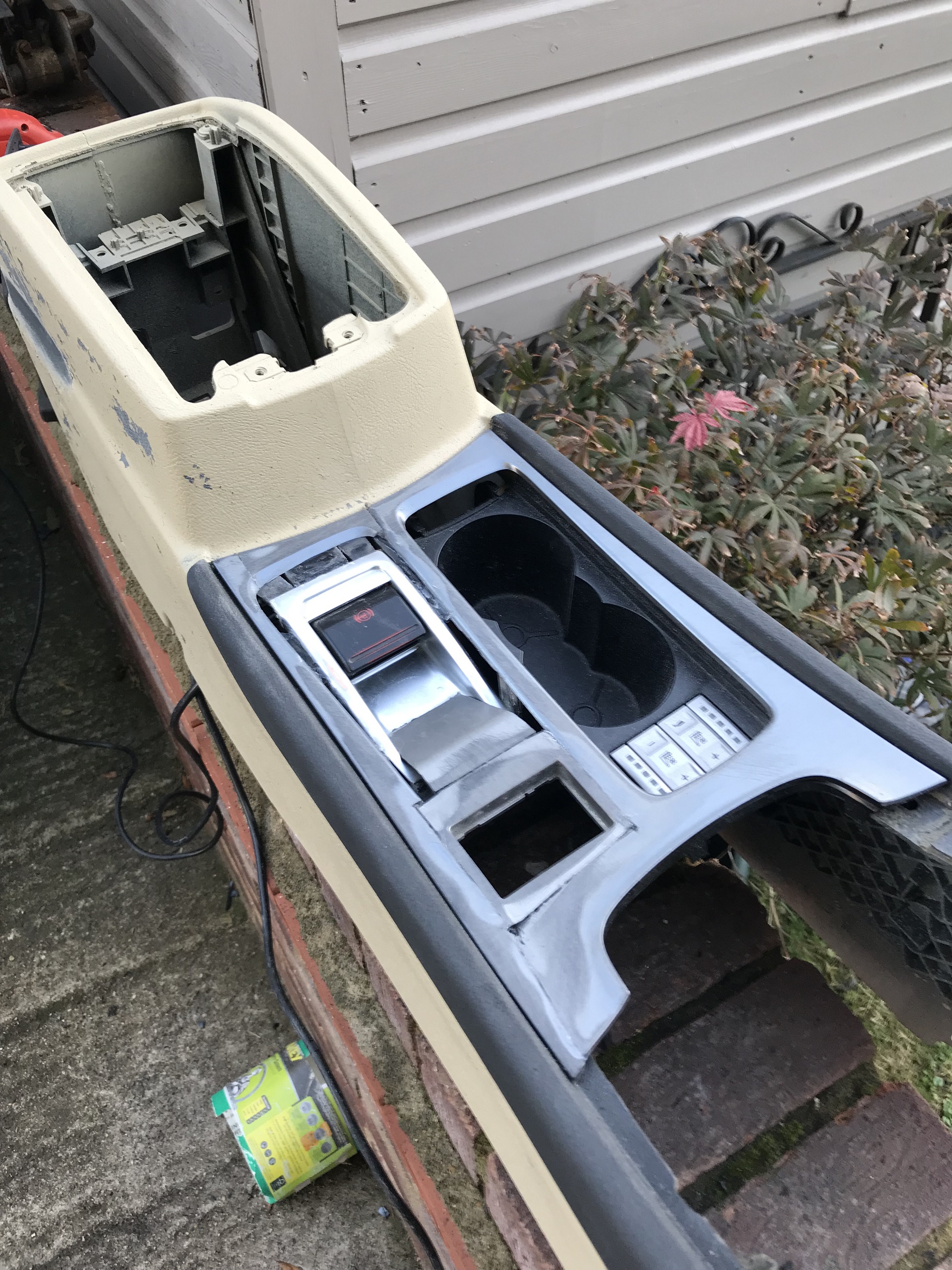

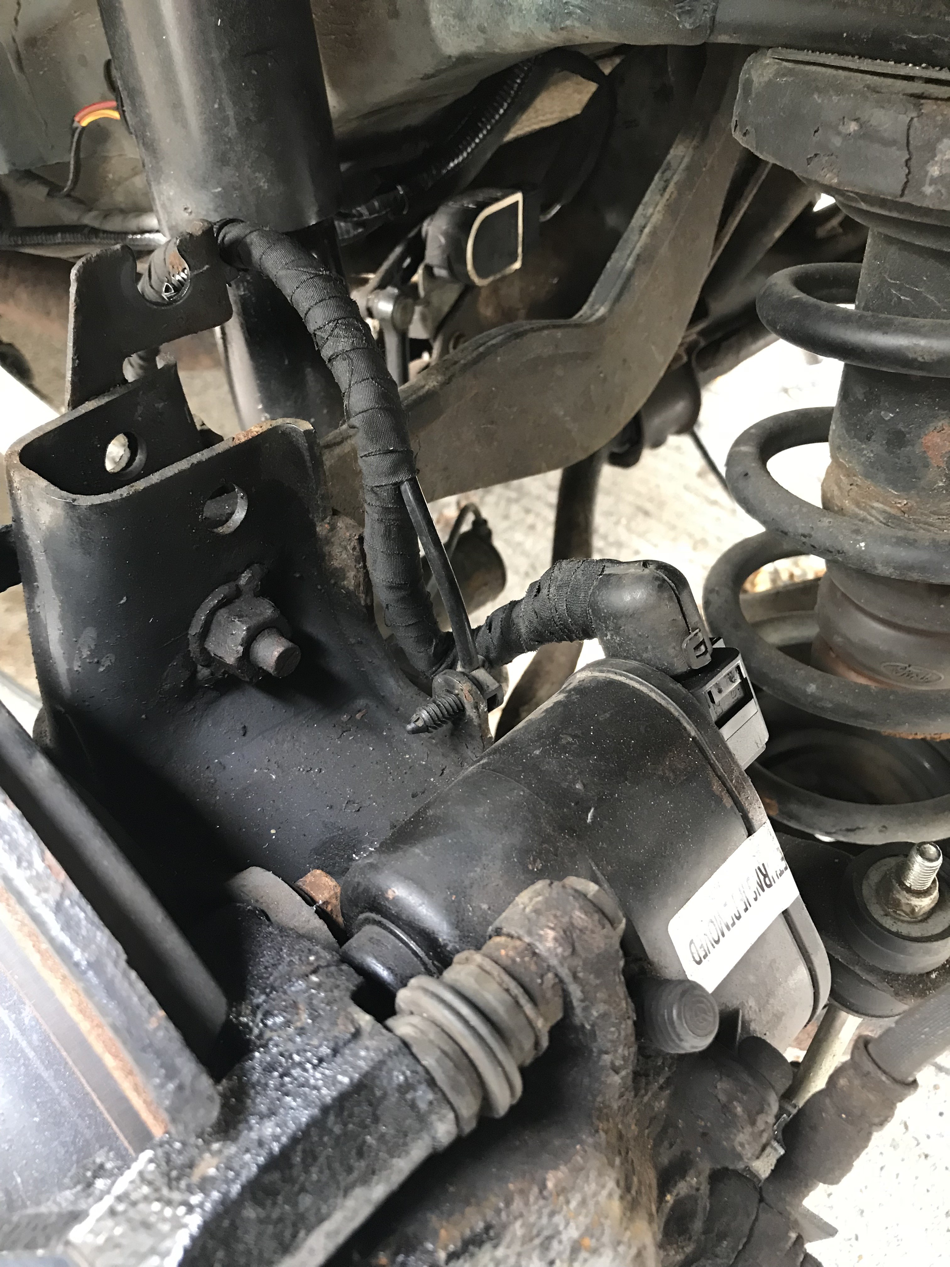

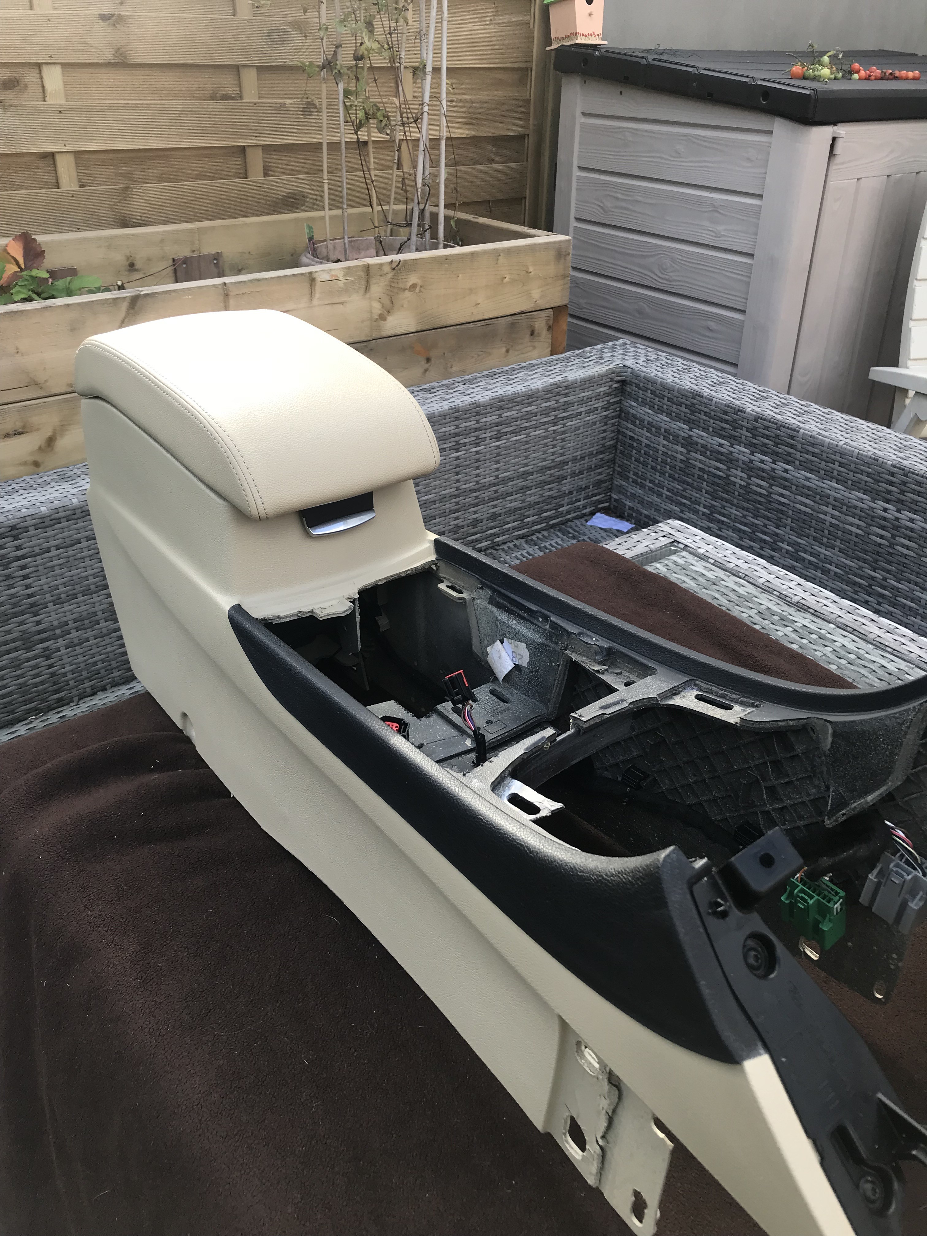

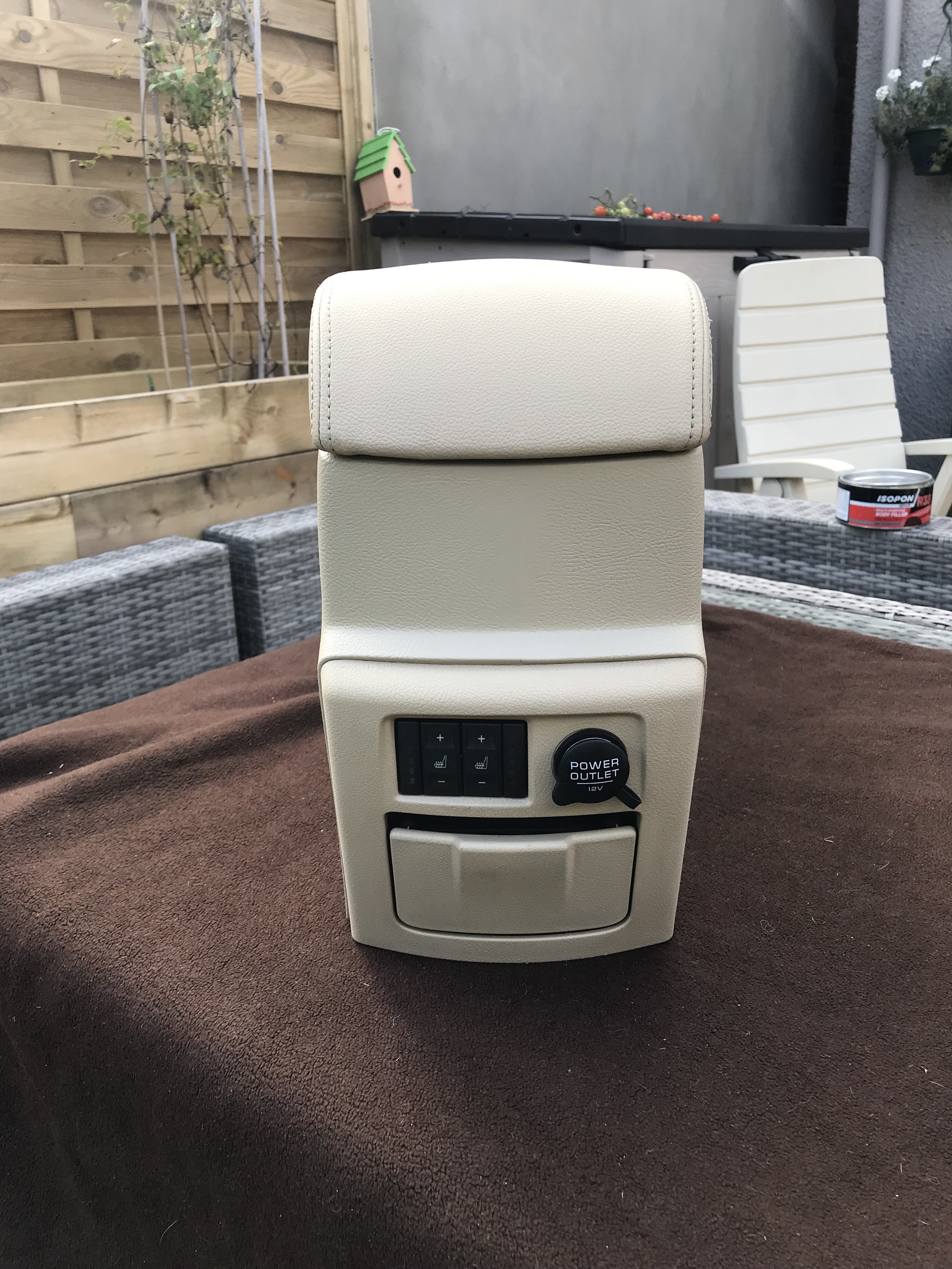

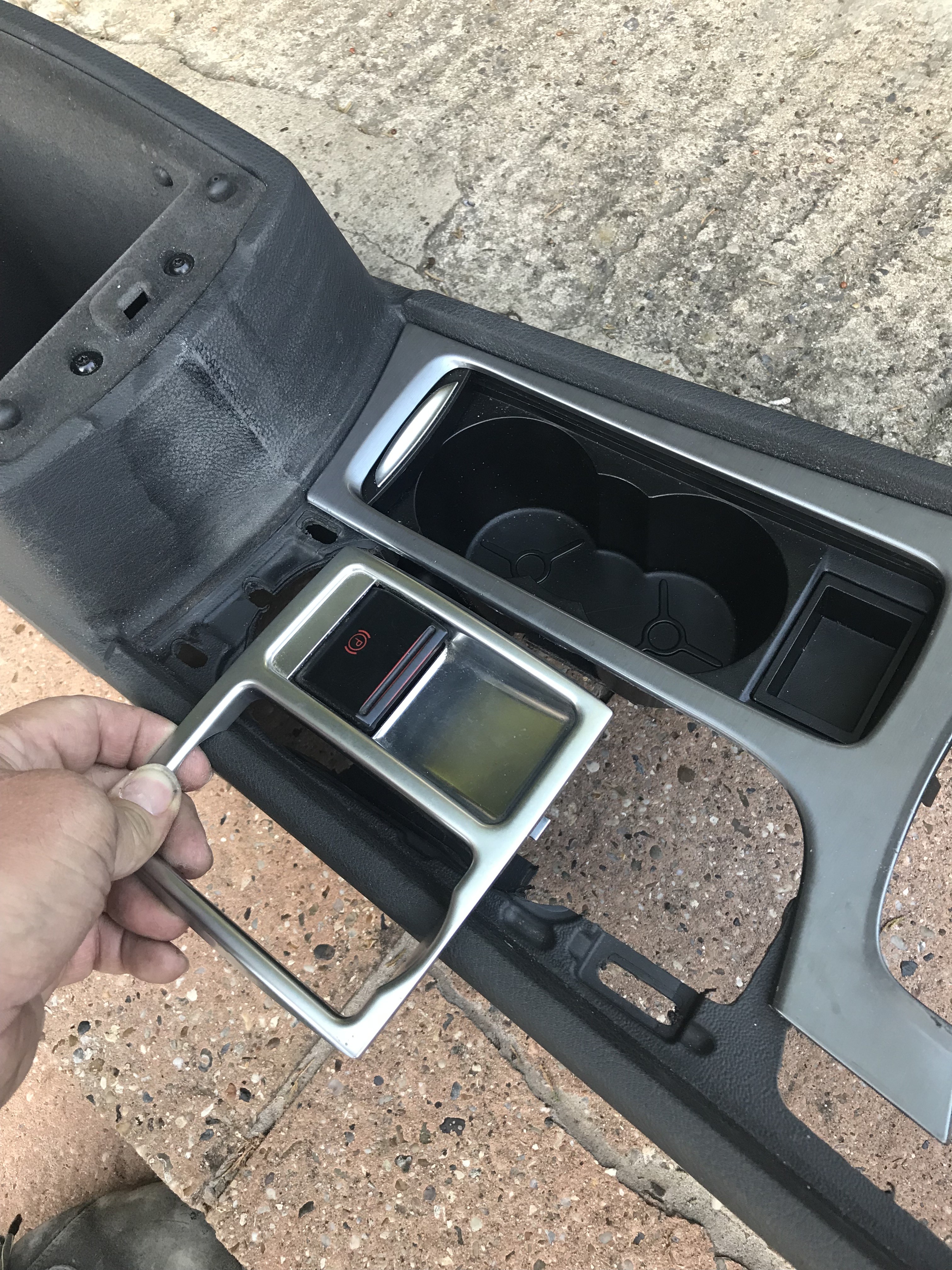

Easy part was fitting the calipers and wiring. Difficult job was centre console. I bought LHD and RHD consoles, cut them both in half and made a new one. Painted in correct colour. If you look very closely you can see the join, but it's pretty good. Then made the handbrake surround and moved heated seat switch over. Finally got all trim pieces hydro dipped.

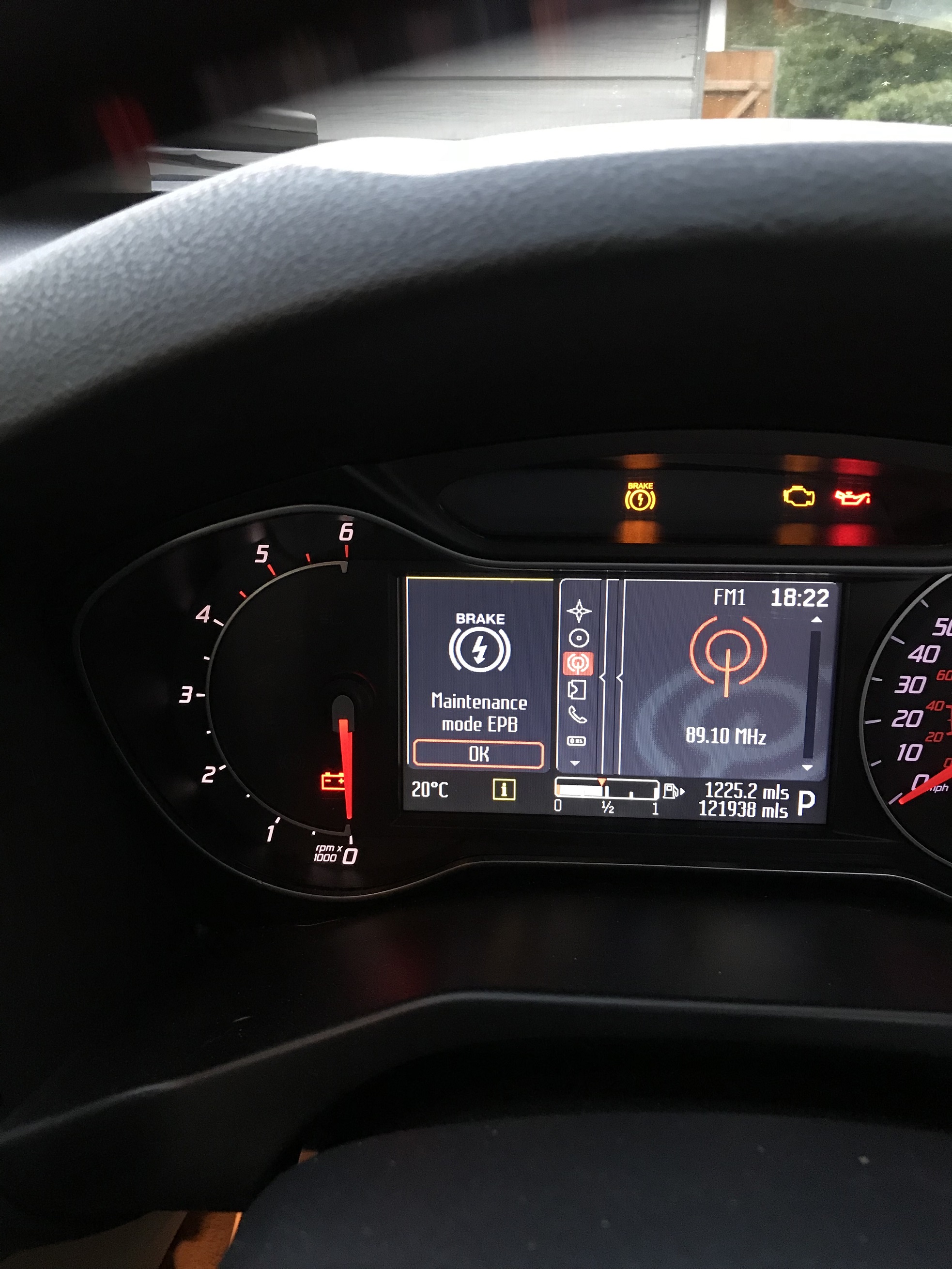

Very pleased with the whole job. I don't know why EPB was never offered on MK4 Mondeo. It is a fantastic addition, and despite what may people say, very easy to put into maintenance mode for changing pads. Everything works as it should... drive away release, which only works if drivers door is closed and drivers seat belt is fitted, and it won't engage if more than 10 kph
If I look with Forscan I have 1 DTC "module configuration not complete" but this causes no issues at all, and no warning messages.
The calipers are not the old, Focus type calipers with a motor and cable. They are just calipers with the motors built into them, like the newest designs

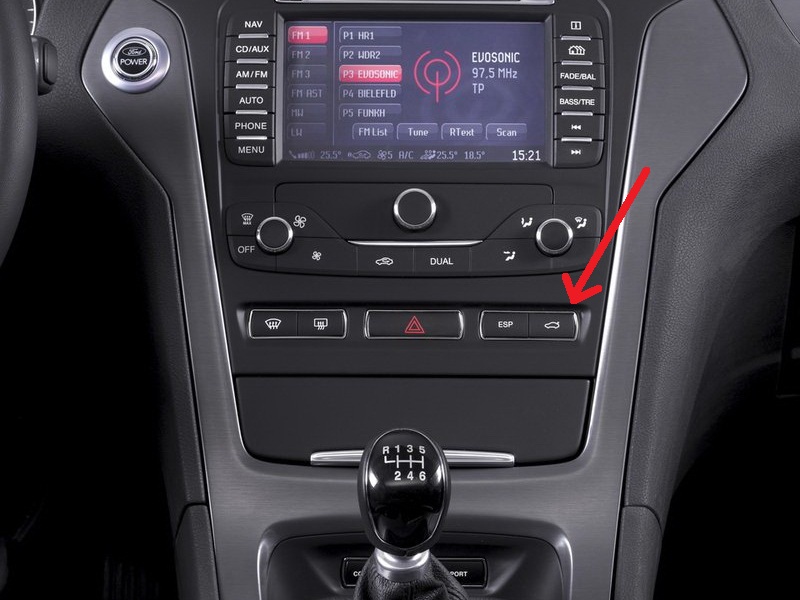

Ah, that does make sense. I googled evosonic, and it is a German radio station. So if none of you guys have seen it, then I guess it is not available. Interesting looking at the MCA, with the "off" button, where it should be a cover plate with only the removal slot behind. Plus the other different labelled buttons. It also has 3rd row air con activated, waste of time on a Mondeo. Doesn't do anything. And AQS enabled with auto recirc. I have this fitted, never an option in UK

Hello. Has anyone seen this switch? It has a tailgate release. I'm trying to find a part number for it. It was obviously never available in the UK and I can not find any information.<img src = "https://mk4-forum.denkdose.de/attachment/28681-fordmondeo2011-jpg/" class = "woltlabAttachment" data-attachment-id = "28681" id = "wcfImgAttachment0"> Many Thanks
