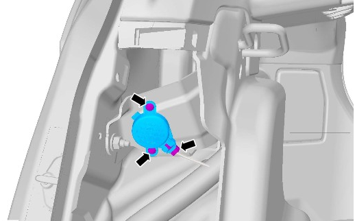

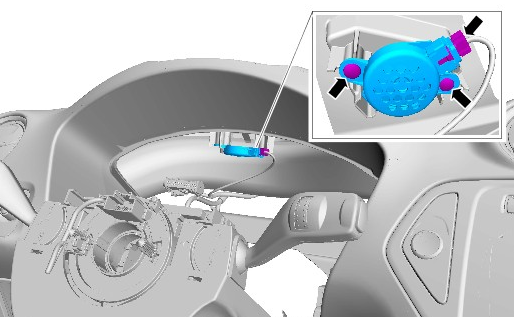

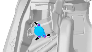

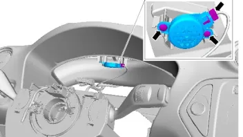

  • As long as we know, the PDC Sound is output on audio speakers with Sony CD6000 radio. Never known of any navigation system, not SD and not DVD behave this way.
    Therefore there are no PDC-speakers installed.
    So i think you need to install those. One is above the Convers+ and the other one in the roof at the C pillar. In SMax, the rear speaker is on driver side (in England) behind the rear seats. Those speakers are rellay cheap. You can get them for about 2€ each (new ones).
