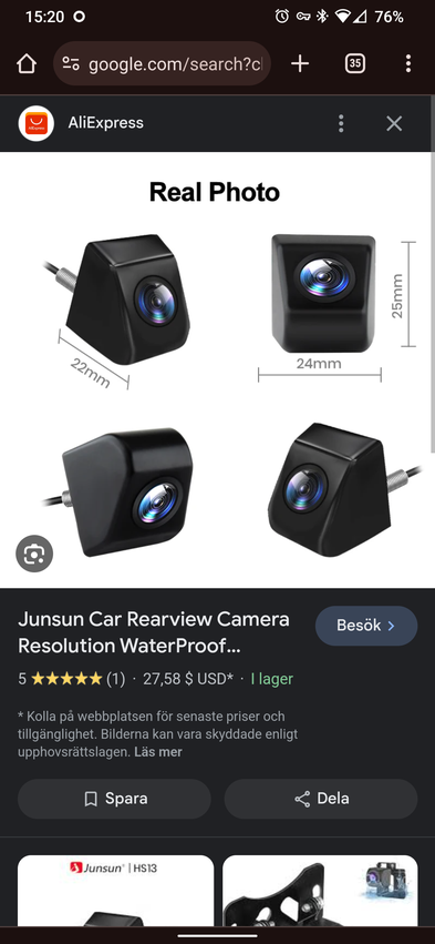

    In the trying to use another reverse camera with my MCA, but when camera is powered on it does not show the image on the MCA display.
    I've tested the camera, it works. I got the camera with my Junsun android head unit (see image).
    Could the camera be sending the wrong kind of signal? The fakra - rca connection is working correctly.
    Does the MCA head unit require some other "trigger" to show the reverse camera image, except that the camera powers on and sends a video feed to the MCA? I thought it just displayed anything feeding into it when the camera is powered.
    Big thanks for any help!
  • I assume the camera has wrong video signal format: AHD (Analog HD),
    Ford needs CVBS (NTSC).
    Some camera models have the possibility to change the video signal format by cutting some extra cable loop.

    Thanks for your reply!
    According to specs it's CVBS (when cutting the extra cable) I've tried both with and without, no luck.
    Good idea though👍
    Edit:
    Ah, crap. I think it's PAL. I guess that's why it isn't working then.
    Edit2:
    Or it might support both PAL and NTSC, I'm unsure...
  • The video-ADC in the MCA can handle both encodings, PAL and NTSC (and some more).
    Thanks!
    Strange, then it probably should work. I'll continue my search for a solution.
