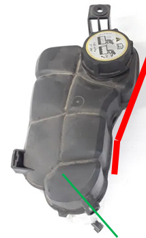

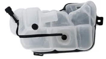

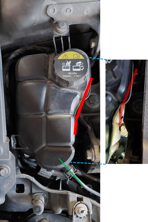

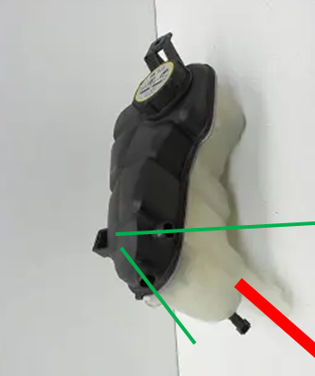

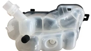

  • Hello,

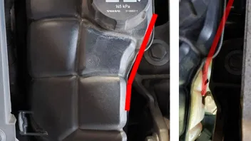

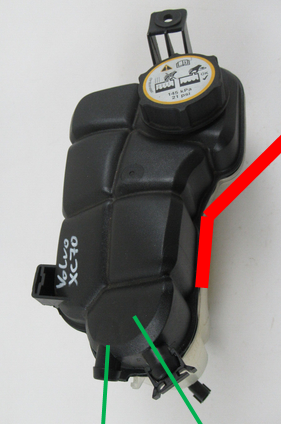

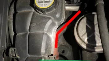

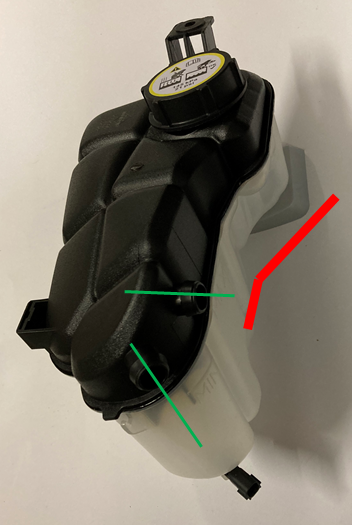

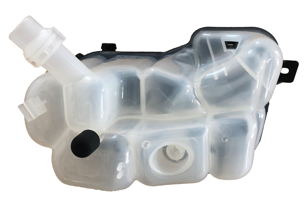

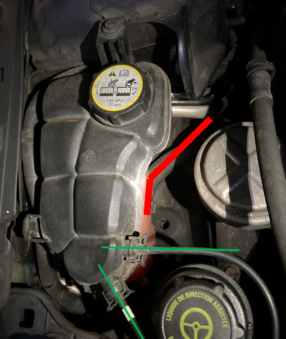

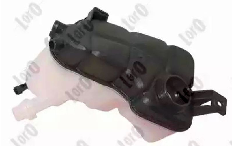

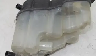

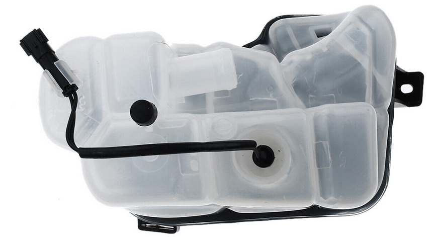

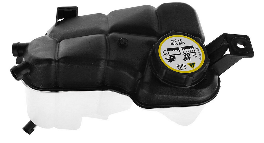

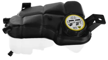

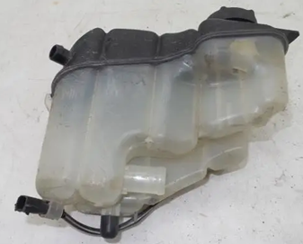

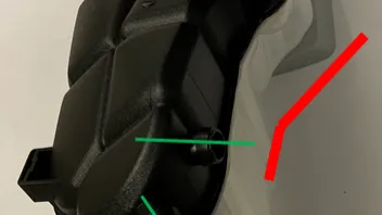

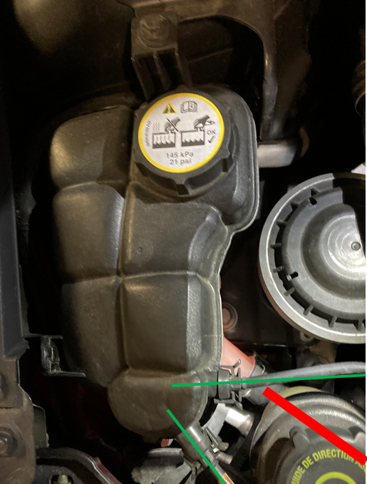

    I just updated #20 (to have it all together) as I found in the meanwhile a 100% fitting expansion tank for 2.5T and early 2.2 TDCI.
    Many thanks to digdog for taking pictures for me of his car! :this:

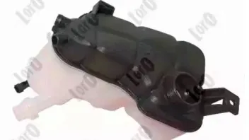

    I also found a fitting version for 2.2 TDCI from aftermarket with really good quality: NRF 454092 Quality "looks and feels" like original equipment.
    So overall for every Mondeo MK4 there's an expansion tank available with Sensor:

    As the availability of a risk free sensor system (as used in series in other cars) is clarified, next step is the harness connector.
    If my cross check is correct, it's a "MOLEX MX64".
    Potential part numbers with code A:
    without CPA: 31402-2100
    with CPA: 31402-2110
    CPA = Connector Position Assurance: the red peace to check that the connector is locked correctly and also blocking the locking mechanism
    Fitting terminals: GET 0.64
    Tyco part number: 1393366-1 for 0,5mm² - 0,75mm², tin plated
    Tyco part number: 1393366-2 for 0,5mm² - 0,75mm², silver plated (works normally also on tin plated pins as counter part)
    As there are so many part numbers, I have to check here more.
    Next topic would be: "How to indicate missing coolant"?
    Checking the sensor I found:
    Coolant level OK => Circuit is closed
    Coolant level too low => Circuit is opened
    So if everything is fine, the circuit is closed.
    So it can not be a signal to put the above mentioned pin 13 on ground. Or it is inverted somehow.
    Is there maybe an expert here, who nows more how this is done?
    Without a real chance that this pin 13 could work, I hesitate to check it with my BCM, not to kill it.
    Looking forward for useful hints and advices... :hi:
